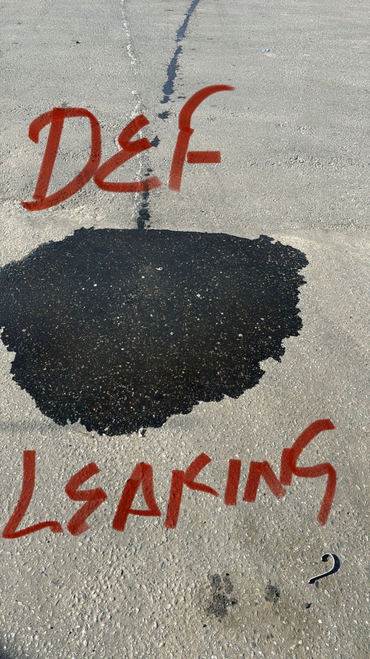

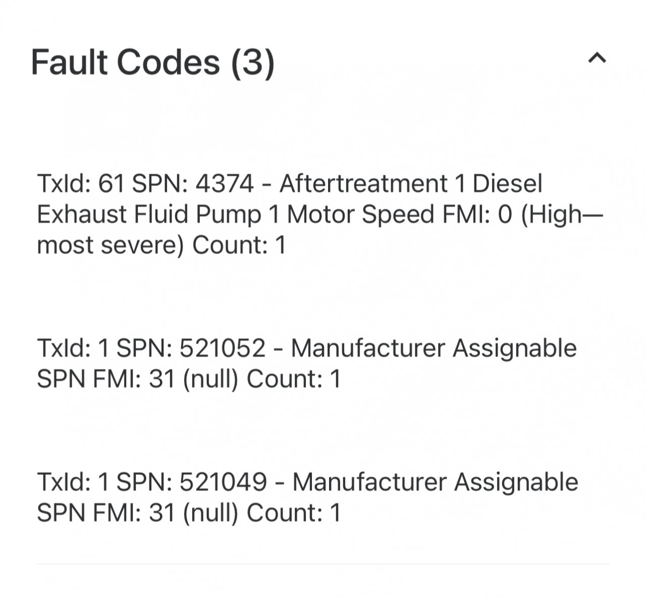

    Good Morning - Last week my 2021 Cascadia had new DEF pump installed in Albuquerque NM. The codes at the that time I had were SPN 5435 FMI 31. Repair shop guys said it needed a new DEF PUMP and we got it replaced.
    New DEF Pump was installed on Monday, Truck drove from Albuquerque to Bakersfield CA. Load was delivered in Bakersfield on Tuesday Morning. Truck was not driven/started after delivering the load till Friday evening. After driving for less than 5 miles, Truck has CHECK ENGINE light on, DEF is also leaking and I checked in Samsara it is not showing 3 codes with SPN 4374 FMI 0.
    Please suggest what is going on.
  3. AModelCat
    29,756
    165,324
    If that is a DEF leak then there's your problem. Pump speed is high because all your DEF is getting sprayed onto the ground instead of going where it needs to.

  4. RunningAces
    RunningAces Road Train Member
    1,308
    2,589
    Jul 2, 2017
    Can you see where the def is leaking from? Crawl under if you haven't already and see if there is a busted line or maybe it came undone.

  5. sonnyca
    sonnyca Light Load Member
    62
    17
    Oct 19, 2023
    Good Morning - Truck is still parked in yard and we have repair shop in the yard. Will go today and see what is going on and will keep you posted.
  6. sonnyca
    62
    17
    Oct 19, 2023
    There was DEF pipe that came off, this is why it was spraying all the DEF on floor. Now we have fixed it and 2 codes are gone automatically but the main code which is SPN 4374 FMI 0 is still showing in Samsara. Check Engine sign is also gone but the solid yellow light is still there.

  7. RunningAces
    1,308
    2,589
    Jul 2, 2017
    Some dpf related codes need a reset with a tool. Some may go off after a couple days driving. No idea what it will be for your particular problem. I'd probably drive it a few days and see if it goes off by itself than go in and get hit for more money but that's just me.

  8. sonnyca
    62
    17
    Oct 19, 2023
    Drove the truck for 10-15 miles and then parked on the side, removed the Samsara device from the truck, power shut off the truck, waited 10 minutes and started the truck. SPN 4374 FMI 0 Code was gone but now I see a new code below :(:(:(
  9. SWM_TECH
    SWM_TECH Light Load Member
    139
    145
    Apr 15, 2018
    Seeing for source address (SA) 23 which is the instrument cluster, that for the ICUCO1T the fault SPN 523002/FMI 31 is listed. Fault description is an EEPROM checksum fault condition exists.
    Fault trouble shooting shows to program the Instrument Cluster Unit (ICU) with the "Newest" software available on server, if available. Otherwise, program the ICU to the "Latest" settings. or the "Factory" settings. If the programing was successful and fault is inactive no further action. If fault is still active after programming it says to replace ICU.
