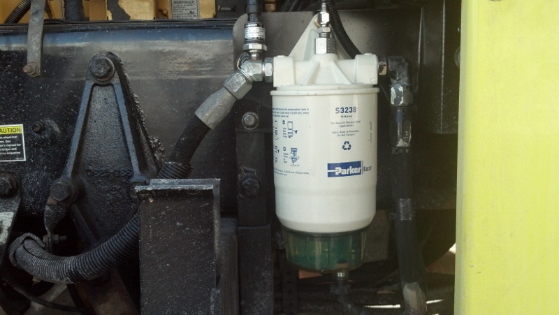

    I had the standard 90gph head then upgraded to the 120gph head with the cat filter. Never was happy with the upgrade. So a few months ago went to this Racor head its a 250gph head with 1.25 inch center threads. The filter is Racor S3238 10 micron 150GPH. Very happy with this set up. The sender coming out of the top is fuel temp, the other sender is fuel filter restriction. This is on a 379 with 6NZ. I been have replacing the filter at 25000 miles, just because it has been convenient to do so. I need to run it until the restriction get's up there and see how many miles it will go. When I changed the filter it was only pulling 6 inches of vac. The filter is expensive, close to $50 The racor number for the complete unit is 3150R. The 10 micron filter is S3238, the 30 micron filter is S3238P. If I went to a S3207T filter, then it would be 250gph filter, The 3207 filter is just a longer filter.
