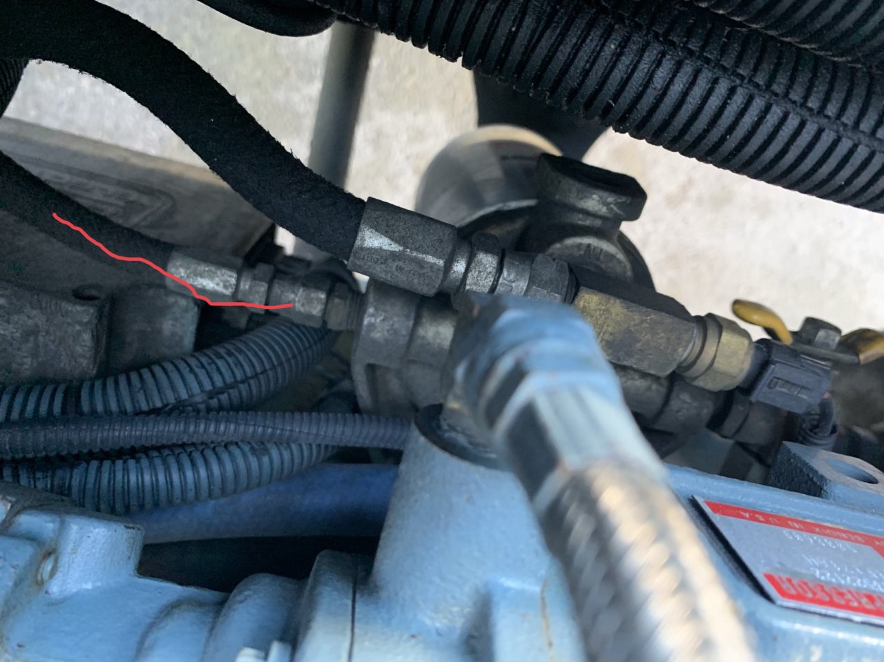

    If you can figure it out, the red line is fuel pressure, you should have a cap on that fitting 56B2298F-61DE-4CEF-A1C2-974C01BEB811.jpeg

    I have the devco fuel filter setup. Is that off the pump?
