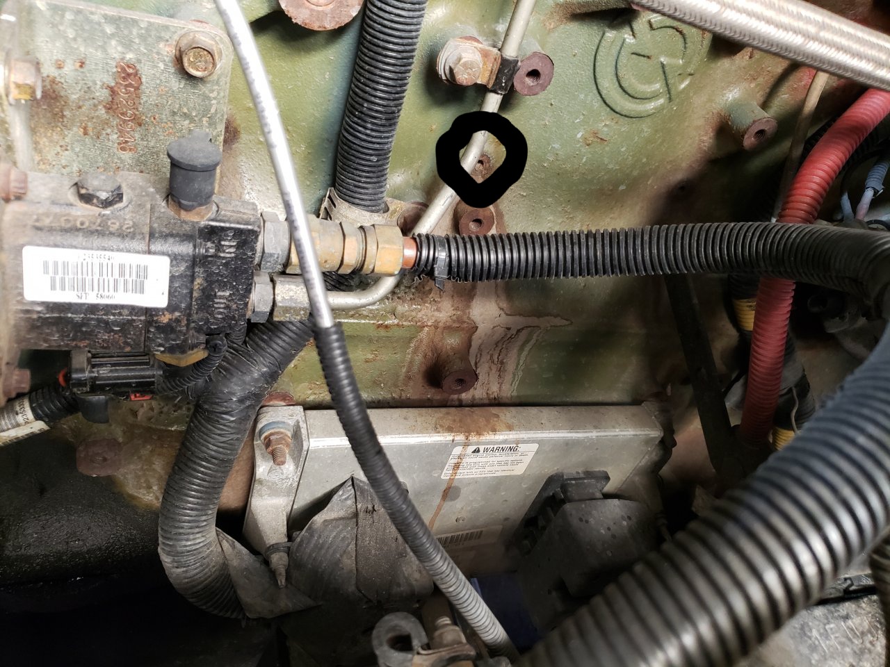

    Can somebody tell me what is this leaking?

    is
    Why its leaking? never happened before..last week i have replaced the water pump and after that i noticed my coolant reservoir's top turned black but no oil found in the coolant..i don't know what is wrong?

    Is it a small corroded freeze plug?
    And, it looks like the engine block - not the frame.
  7. jamespmack
    There are 6 of those holes with normally a black hand push in plug. When they are gone, missing and leaking. You need cylinder liner orings.
    Sorry for the bad news.
    xsetra, Dino soar, Judge and 4 others Thank this.

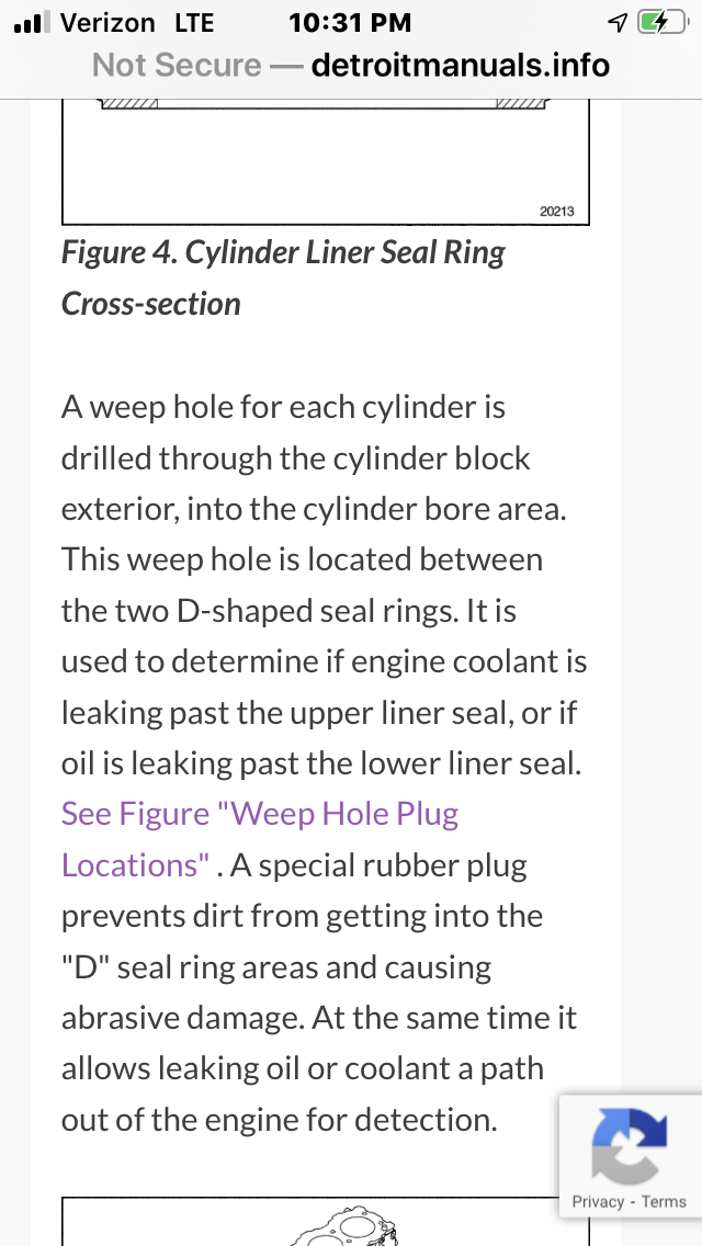

  8. Rideandrepair
    17,584
    56,954
    Aug 8, 2015
    1B86C806-5787-43A7-87E1-7F21DD83D1FD.png 823D4E98-BE4C-4B2C-A965-A90F9E5E8A95.png Short answer, illustration #5 upper D ring is leaking coolant.
    tupperwolf, xsetra, Dino soar and 2 others Thank this.
  9. sunny84
    sunny84 Bobtail Member
    26
    14
    Jun 19, 2016
    What should i do now?
    jamespmack and Rideandrepair Thank this.
  10. sunny84
    26
    14
    Jun 19, 2016
    What repair it needs now?
    Rideandrepair Thanks this.
  11. Rideandrepair
    17,584
    56,954
    Aug 8, 2015
    Head needs to come off. Cylinder removed, inspected, re used or replaced. O rings replaced. Re installed, with new head gasket and bolts. With all the Labor costs. Might as well spend a few thousand more and do an inframe overhaul, while the heads off.
