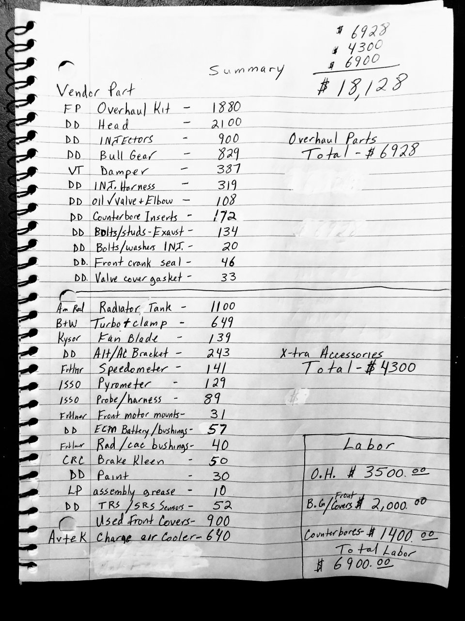

    I will definitely look into it. Thanks again for your help. Roughly what did your in frame cost at then end?

    Yes, it was $2050, from Stoops Lima Ohio. My local Detroit Dealer was higher on parts across the board. Same parts. Mahle makes the OEM original pistons for Detroit. All the aftermarket kits come with rods and mains. The Detroit kits don’t. They’re extra, along with a core charge for the old ones. Supposedly they want them for research. Generally the Aftermarket kits are $2000, while Detroit kits w/ bearings are $3000. 2/3 the price, and they are good kits. The main thing I’ve heard from Mechanics is the quality or fit of some gaskets, on some kits. FP, Mahle, and others have information on their gasket technology. Head gasket being my concern. Had one blow on my 99, at 540k. Engine had never been apart. Proper cylinder height, cutting block counterbores if necessary is key. Using inserts, means cutting a lot of the block. Instead of just cutting a small amount and using thin shims, like they used to. They come in 3 or 4 thicknesses. Depending on wether they’ve but cut already. Maybe the gaskets leaking now, because they skipped the counterbores.

  10. Rideandrepair
    17,584
    56,957
    Aug 8, 2015
    Here’s the breakdown. Injectors are usually $2000 for a 6 pack. I didn’t do rockers, they’re $2100 reman exchange. I may do them in the future, along with a new oil pump, and cooler, accessory and power steering drives.
