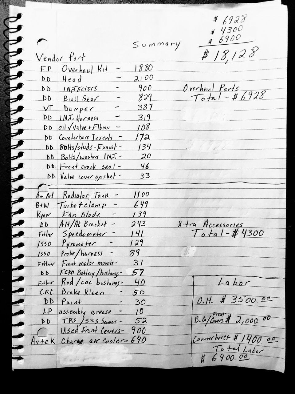

    I was thinking around that price range. Thank you for the breakdown
