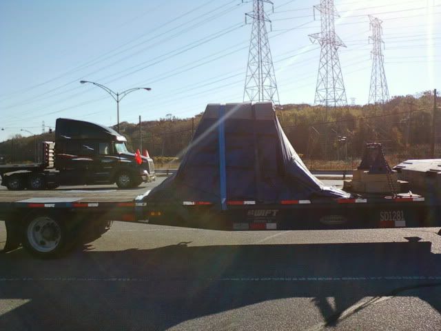

    Nice loads.... What are these??? Chassis of what?

    future RV's

    Ok, So that's boats on the other side then...

    Yep that would be a TMC truck on the boat fleet

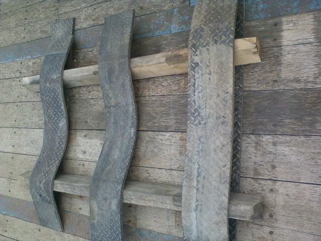

    [​IMG] the coil rack

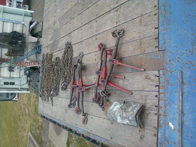

    [​IMG] chains, binders and edge protectors

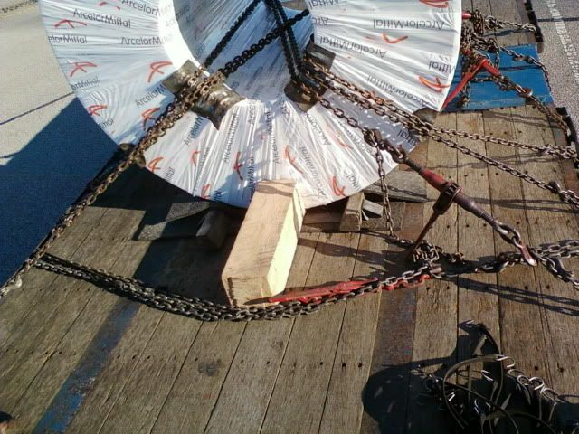

    chain pattern
    bulkhead, not the best but present. beveled wood was to long to put sideways, also with these step deck trailers it is best in my opinion to haul coils suicide due to the weird chain tie down points

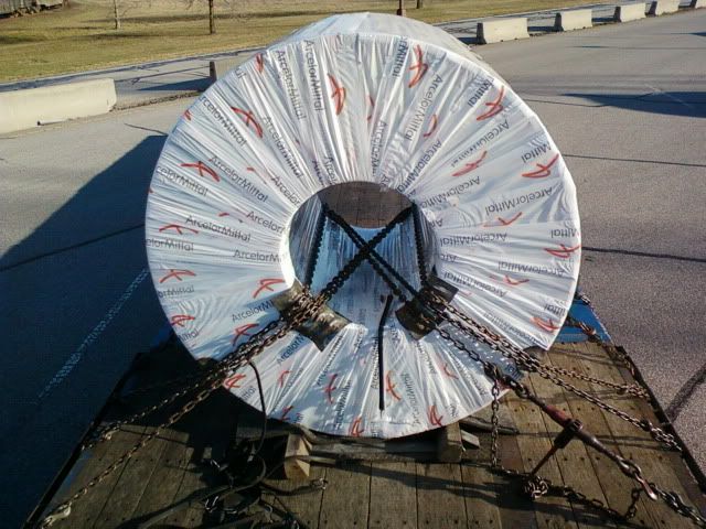

    [​IMG] finished product
    total ammount of chains-7
    straps-2
    weight of coil 39,000lbs of steel+ 30lbs of paper wrapping it(hey it was on the BOL)
