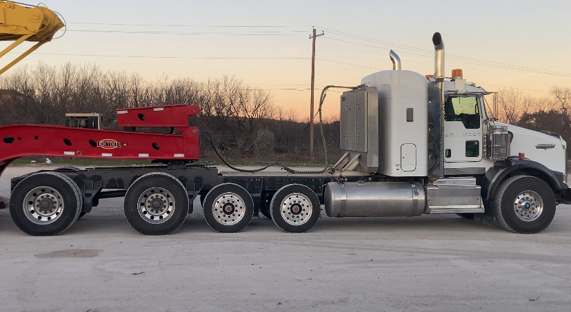

    then there's this. Parked next to this in junction tx one afternoon.

  7. ElmerFudpucker
    7,195
    78,787
    May 17, 2024
    That’s quite a setup
