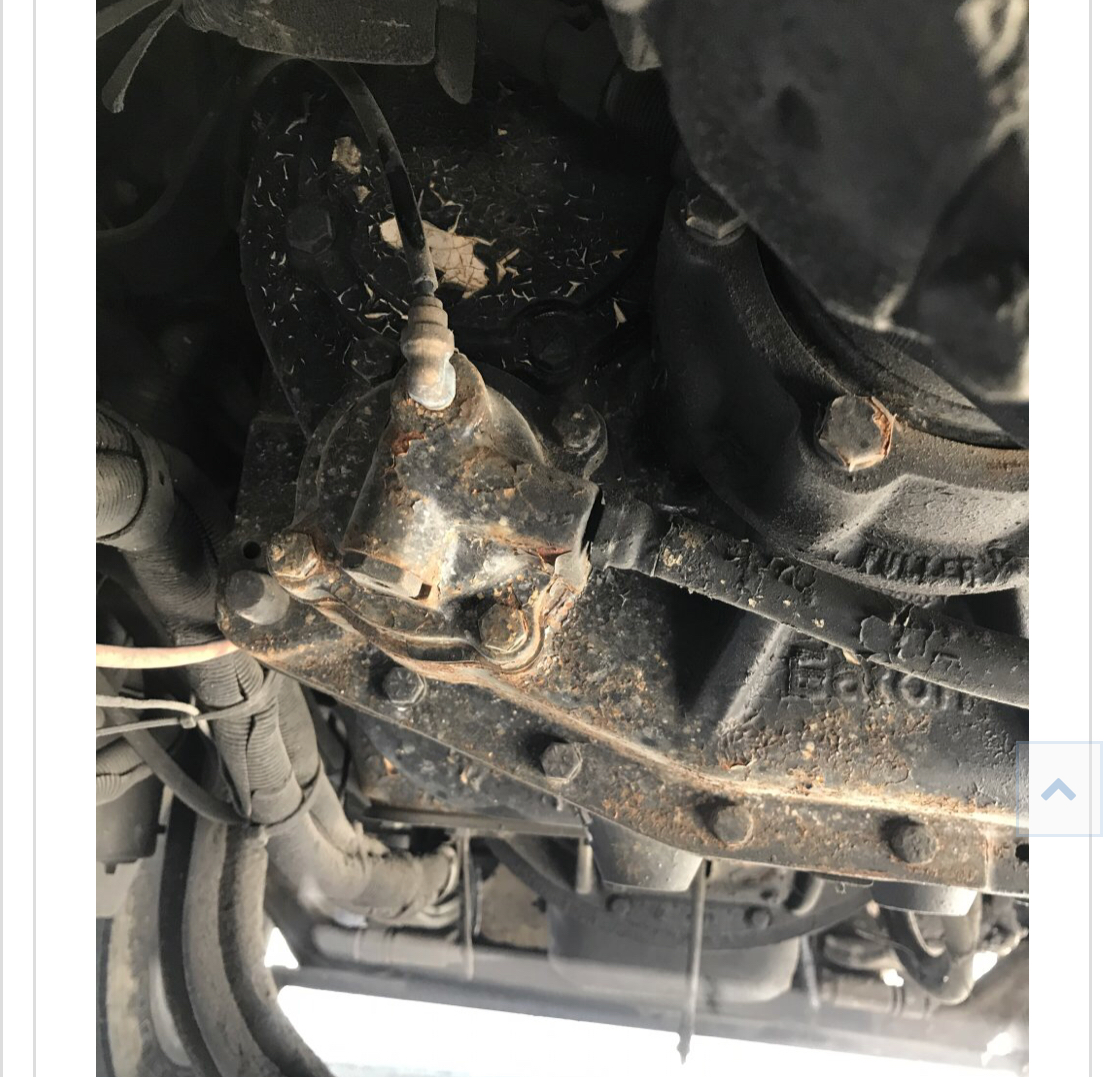

  11. SmallPackage
    5,827
    18,681
    Dec 20, 2019
    Marion Texas
    2C536435-E1D5-42FB-91E3-8408AE8B604F.jpeg This cylinder you dont mess with. Just hook that little line coming from top to the R on the old style knob. It is the splitter.
