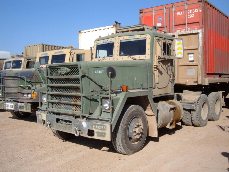

    i drove some volvo and Mercedes european trucks in iraq, and yes the transmissions were like driving a car, 8 speed, they are cabovers, i really liked them, however much more room in the conventionals over here, i felt safer in the international conv that were up-armored at the factory before being shipped out to Iraq. maybe off topic but here are some pics of the trucks we used in Iraq. merc/international//freightliner/am general

    Hi Bryce: Thanks for the pics. How are the military Internationals speced? That CCC truck looks like quite a beast?

    They were auto transmissions with a clutch, interior much the same as here, fully armored including the floor, very heavy, they are being left over there as they are to heavy for use anywhere else, they were slow and needed about twice the distance to turn around compared to other conv trucks, i was told they cost $500k each, i was a civilian contractor for the US Army
