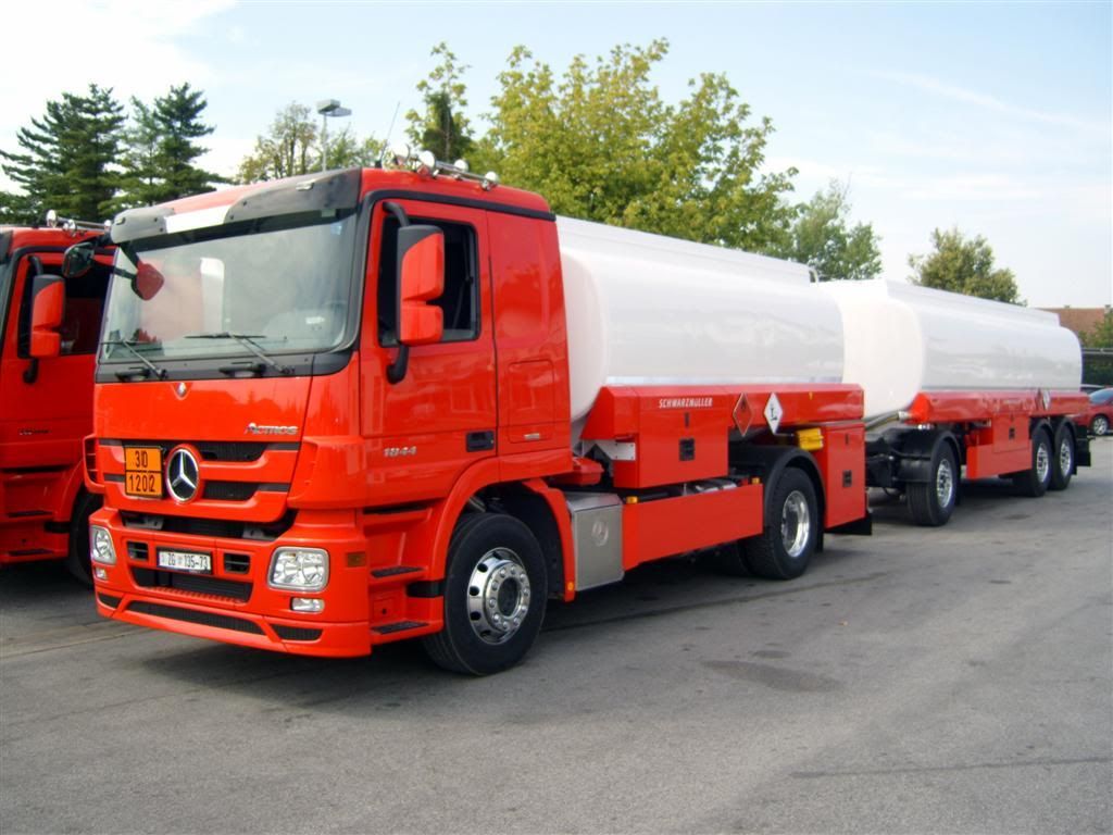

    one nice setup
    usually for fuel we use mainly only tractor+semitrailer combination but for delivering of heating oil ( red diesel) for delivering of fuel for construction sites and similar this setup is used....
