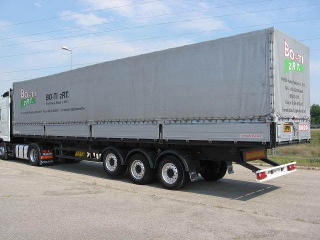

there are some uninsulated reffer trailers just normal curtain sider
there are some insulated but still looks like normal trailers
and there are trailers which are almost identical to normal reffers but with curtain on left right and top are fixed .....this is 2-3 inch thick curtain with insulation they are mainly produced by spainish manufactures
there are curtain sider trailers without agregate and refrigerator system but insulated looks like normal trailer but can hold temperature good
when you load freight at 4C or 39F in 24hours temperature will raise only for 1C or 1.8F , mainly used for flowers......
but when you say curtain sider you never know what trailer really is
no one would ever say that this one is tipper

Yup I've contemplated buying one of those, wish I had maybe loads home mightened be so difficult now, it's the best of both worlds! I've seen Alot if Spanish curtainside reefers, great for fruit and veg as well as dry freight, I maybe wrong but I think not so good for frozen
