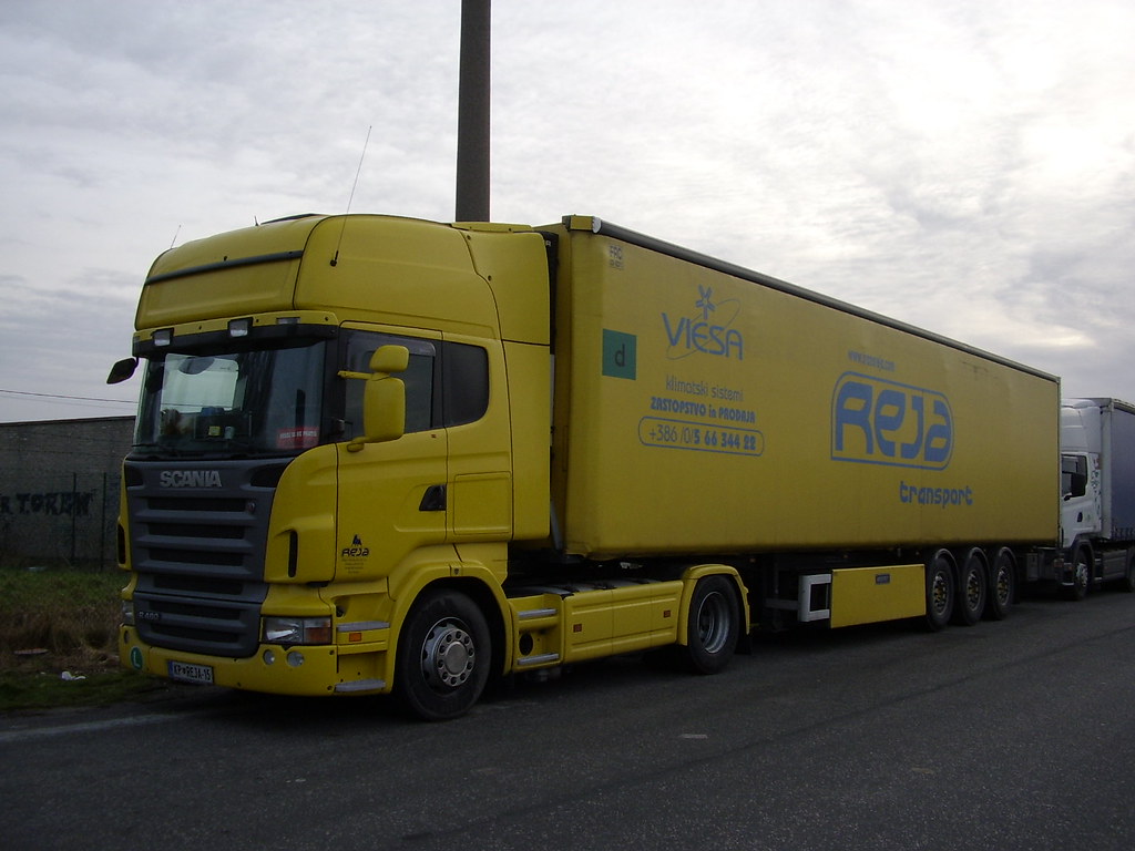

so this is one of those insulated trailers only left and rear side can be opened
trapolin is ~6cm thick
and trailer looks like this

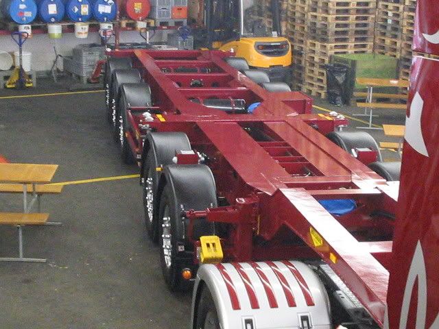

There are also combi and eco combi container trailers , these are trailers that can be split in half to deliver 2 20' containers independently or 1 40/45' container or in the case of the eco combi 3 20' containers or 1 20' container and a 40/45' container
http://i300.photobucket.com/albums/nn31/Florian142/Container handling/IMG_0008.jpg
http://www.d-tec.nl/Files/Upload/cbbd624d-0c21-433d-87e2-8a68365a3e84.jpg -
