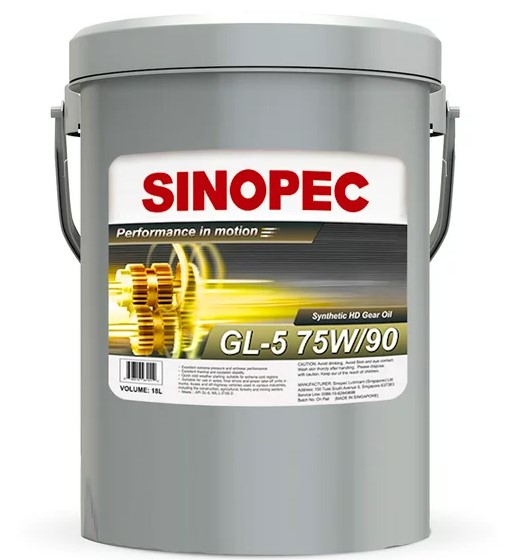

    Hello
    General dumb question, I think I know the answer but I just want to confirm with the experts.
    Volvo VNL and most 6x4 trucks the rear differential is the one tractioning all the time, is that correct?
    Which oil are most popular out there for the differentials?
    I found Sinopec for $109 per bucket.

    For manual trans, diffs, trailer and steer hubs, I've used synthetic 75-90 for over 20 years.

    You should re think putting gear oil in any manual trans. This is not the approved fluid for transmissions.

    Thanks for the info, but I'll just have to wait for you to tell me why I shouldn't put the same Synthetic 75/90 in it. I'm not gonna waste time looking for a reason.
    If you want to explain, tell me also what difference it will make over the life of the transmission.

    If that’s true then why every time I install a rebuilt manual transmission from Inland it has a tag on it recommending to use synthetic GL 5 ?

    Eff it, I lied and looked.
    I've used this Castrol 75 90 forever. It's in the new Fuller 18speed in my truck right now, and the same oil I used in all of my customers equipment for years.
    Can't remember about Weller, but for the full 5yr warranty on new Eaton trans, you have to also purchase an approved oil and clutch, or just an approved oil for diffs.
    Every trans I bought included a 5gal bucket of this oil, and usually an Eaton Easy Pedal

    pretty sure I've always been sold 50w oil for transmission.
