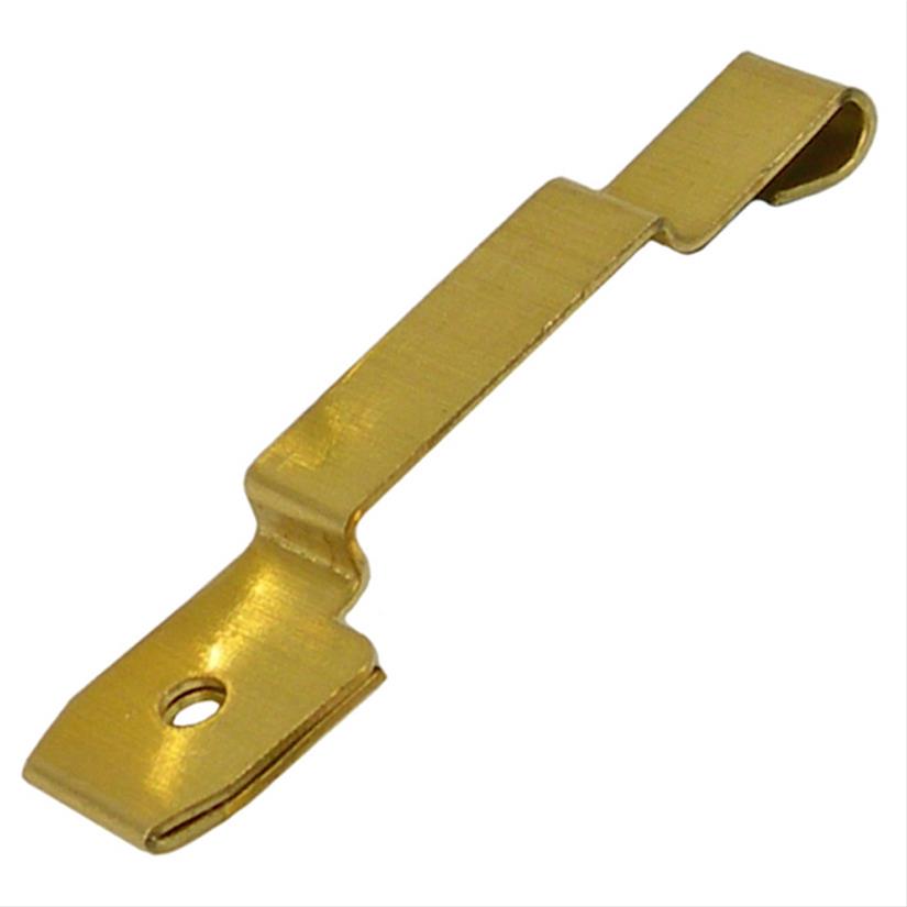

    Exactly. Two of these to replace the fuse, 1 inline fuse, a few feet of wire and a switch. Ten minutes to gear up and that includes drinking rum and cutting your thumb stripping the wire. A612DAB3-9B3B-49A9-8A05-2B912E219CE7.jpeg

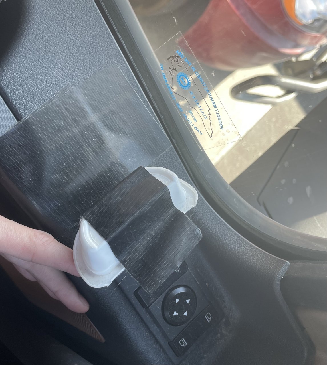

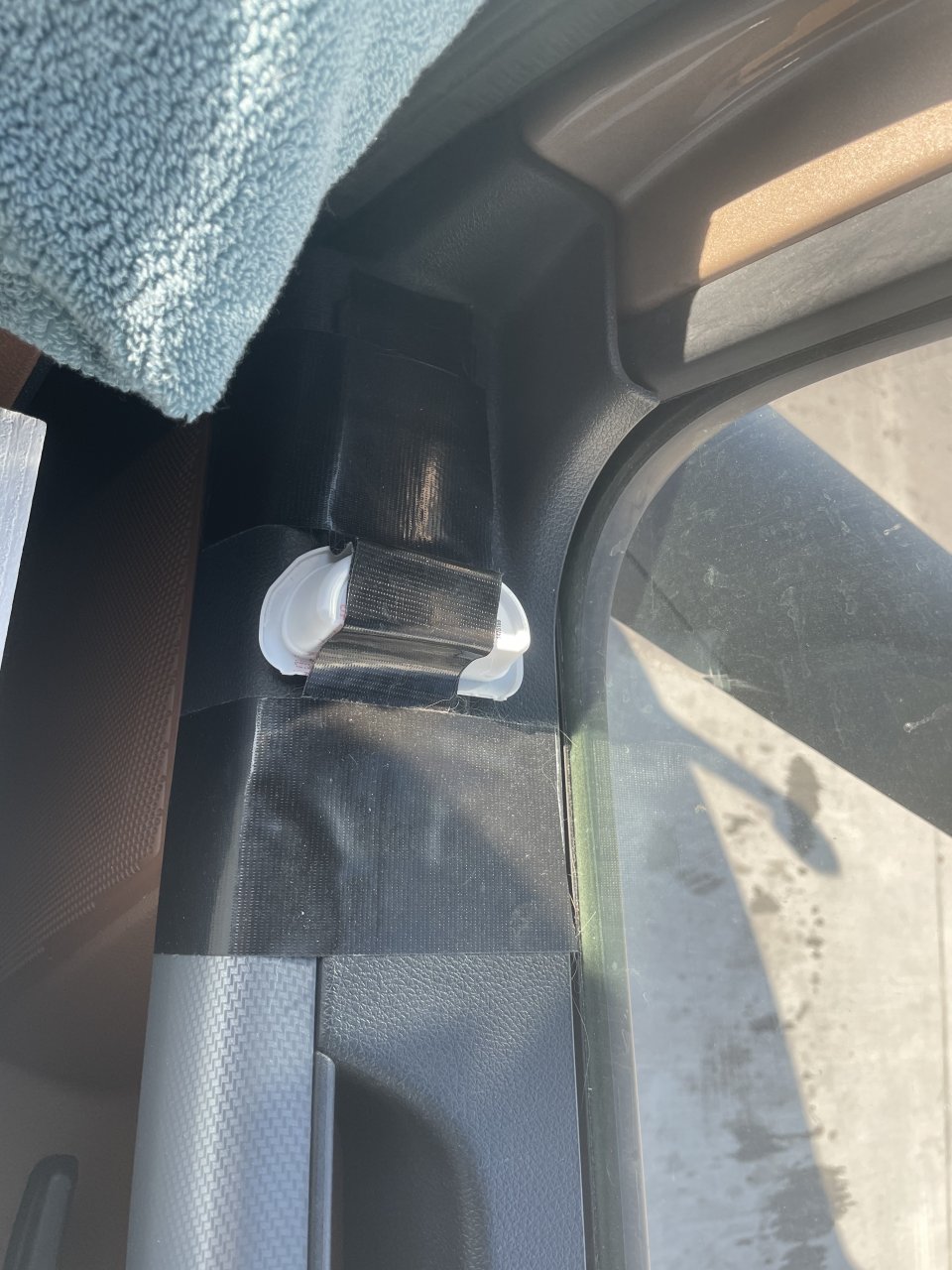

    I have cat. I use duct tape and plastic whiskers food containers.
