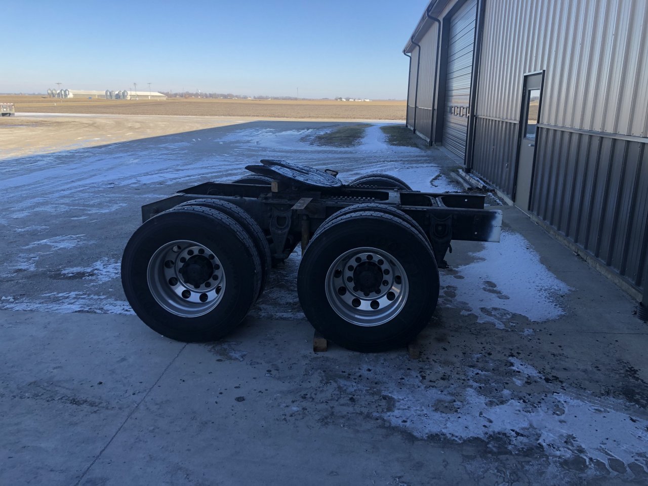

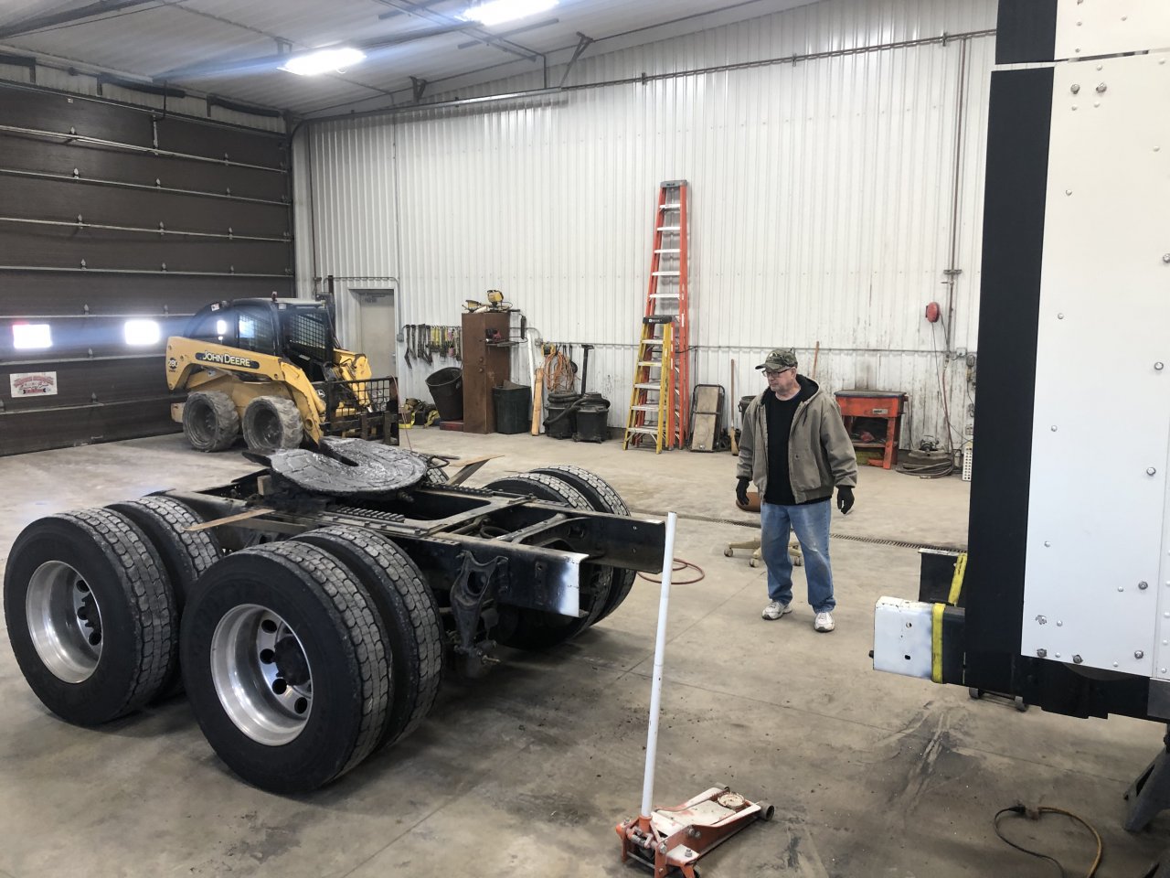

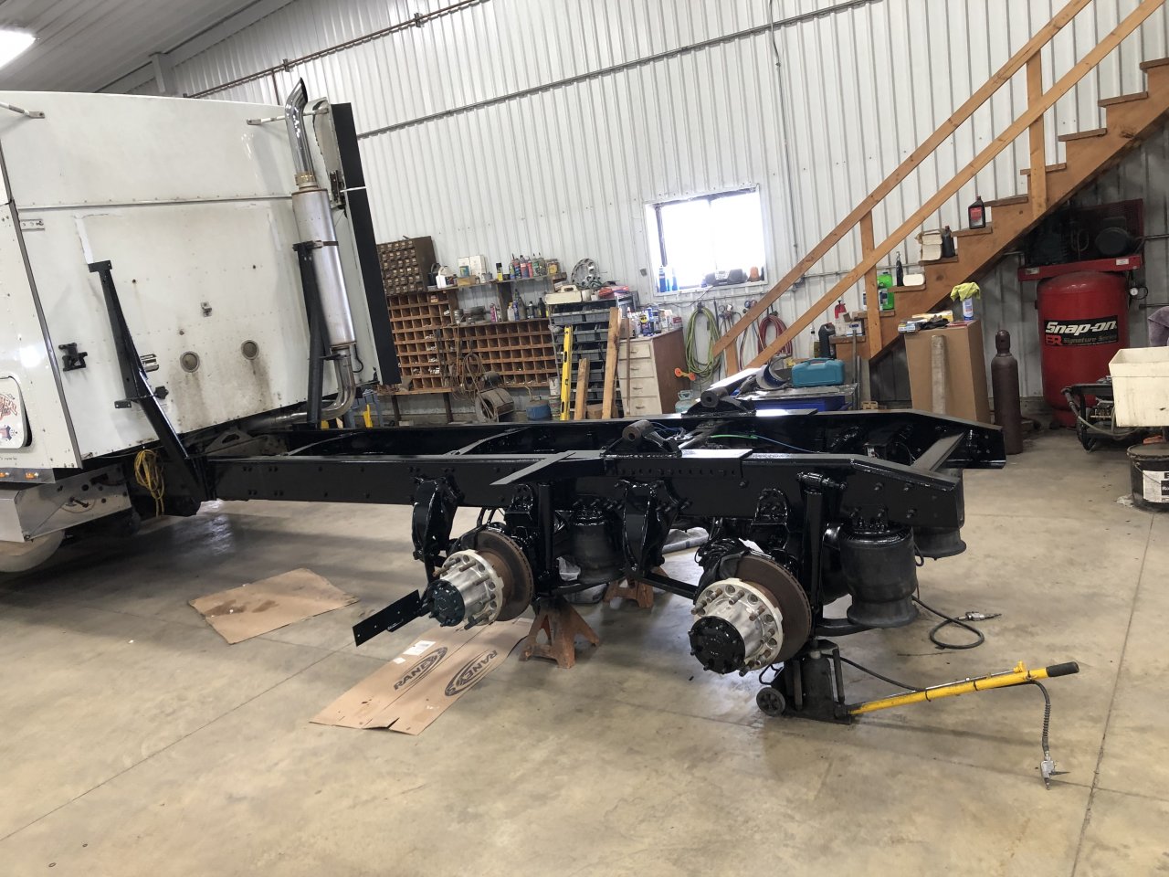

    The only way it make financial sense to me is if you get a good deal on low mileage axles. To piece it together would be super expensive. When I got my new trailer last year I wanted disk but there just weren’t any available on the lot and it’s like a $5k upgrade when ordering a trailer. DCF30E70-6A6E-439C-8E36-EC426D3545B0.jpeg D9D65C75-70A9-40C5-B0C3-9F7929DAFB9A.jpeg 808A5F88-FB6A-4F54-BF52-A6A6E76F9E29.jpeg

    I get it that a lot of people think disc are better, but are they worth that much work?

    Well my whole back 1/2 had over 1 million miles in it AND I was looking to change gear ratios AND looking for a bit more catwalk. Came across a 3.08 airliner setup with only 60k miles in it I was hooked. Having disk brakes made it all the better.
    I spent some money over the years trying to improve the drum set up it had. But nothing compares to having disks there now.
    I wouldn’t of done it just for the disks but super glad it was part of the package. my next trailer will have disks without question.

    Man you are so talented lol.
    You'll love the disc's. Night and day just like a car.

    Could we get some close ups of the splice please?

    Well that makes a little more sense. I've swapped cut-offs before, heck of a lot easier than adding new axles and all the hardware to your existing frame.
