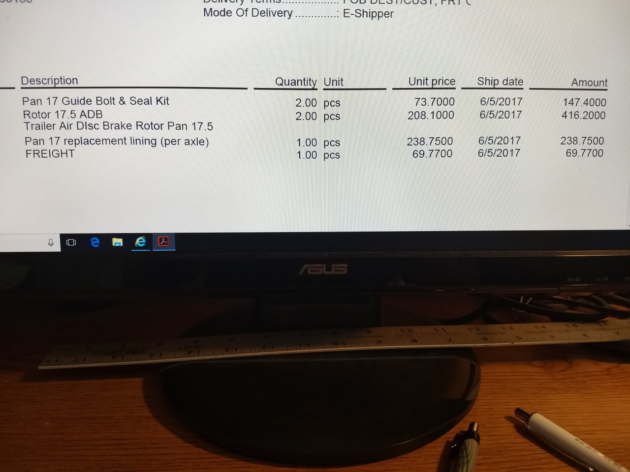

    Prices in attachment.
    $75 caliper rebuild kit
    $208 Rotor
    $238 pads, 4 pieces 2 each axle end.
    MartinFromBC and KB3MMX Thank this.

    So you got both sides of the axle. New rotors pads and calipers for 700 bucks? Something aight right with that quote. I can't even get generic ones from auto zone for my old f150 for that price.
  9. xsetra
    xsetra Road Train Member
    5,198
    7,150
    Aug 21, 2011
    $700 was price for complete caliper with pads.
    Not including rotor.
    Rotors were $200 each.
    MartinFromBC, KB3MMX and spyder7723 Thank this.

    Gotcha. Thanks for the clarification. So 1 axle pads and rotors are what? 500?
  11. xsetra
    5,198
    7,150
    Aug 21, 2011
    Per axle end.
    $208 rotor
    $120 pads
    Purchased from Dexter trailer products
    Ingersoll, Ontario
