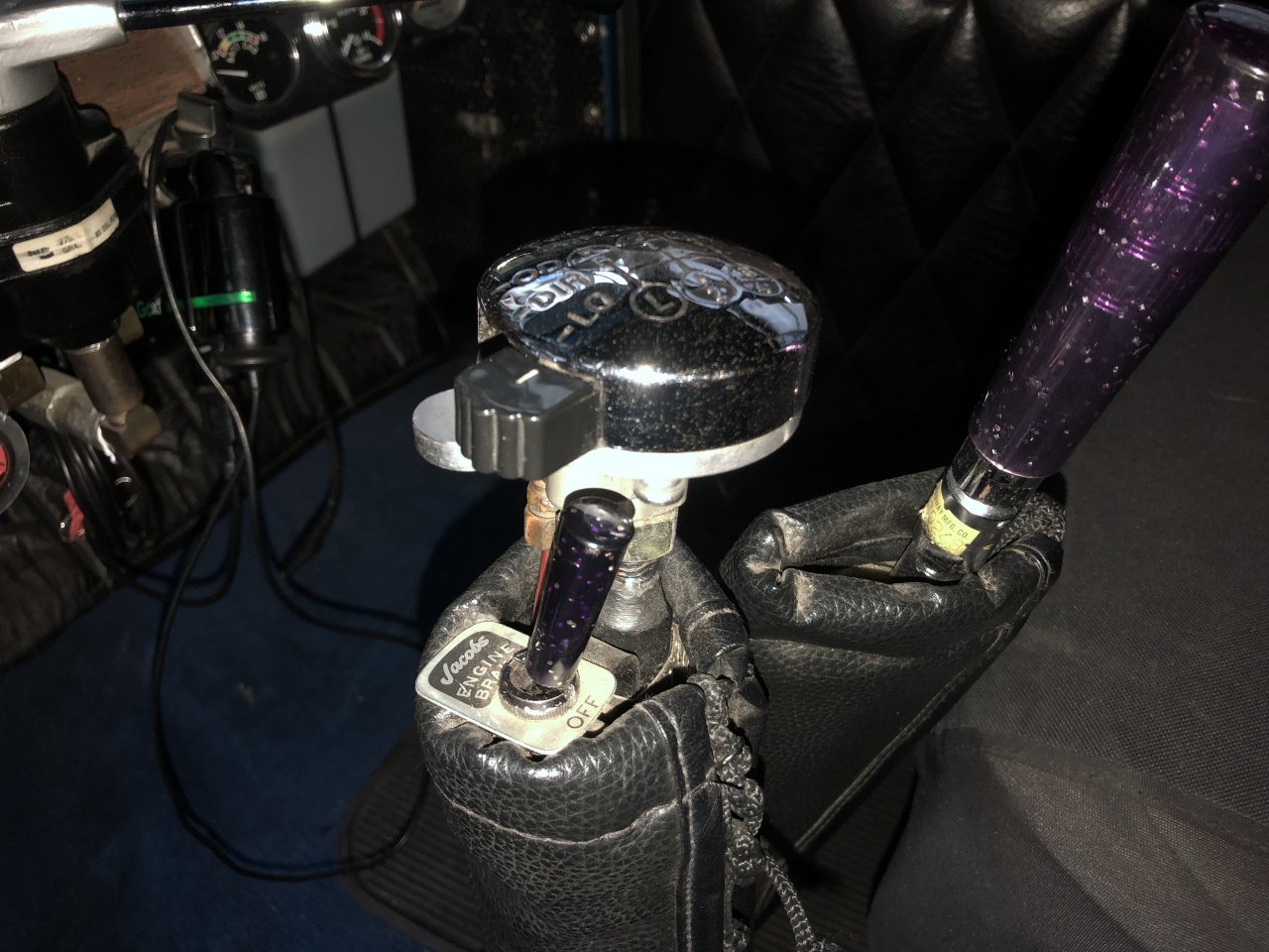

    Yep same here. Elderly 13 Od.
    Still won’t use it to shift tho. Lol!
