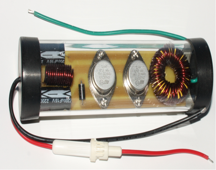

    NAVONE N-700 DC Noise Filter. $39.95
    www.davidnavone.com
    JJD, do you recall the approximate dimensions? Thx

    That's the one I have...it's big...like 5 or 6" long if I recall.about the size of a toilet paper roll.
