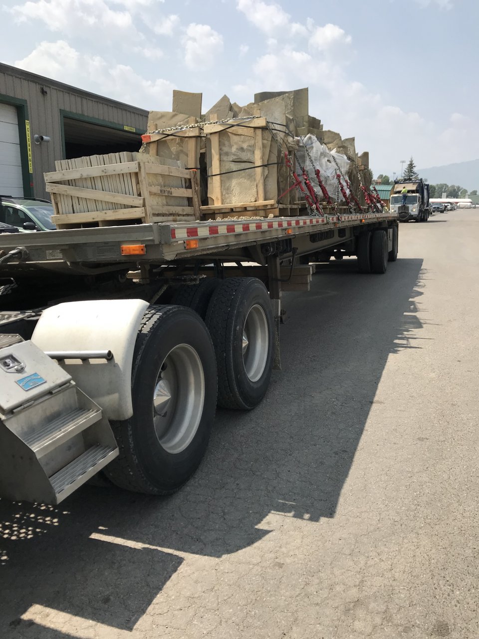

    I’ve had similar, but they are crated up. You use chains over the wood of the crates.

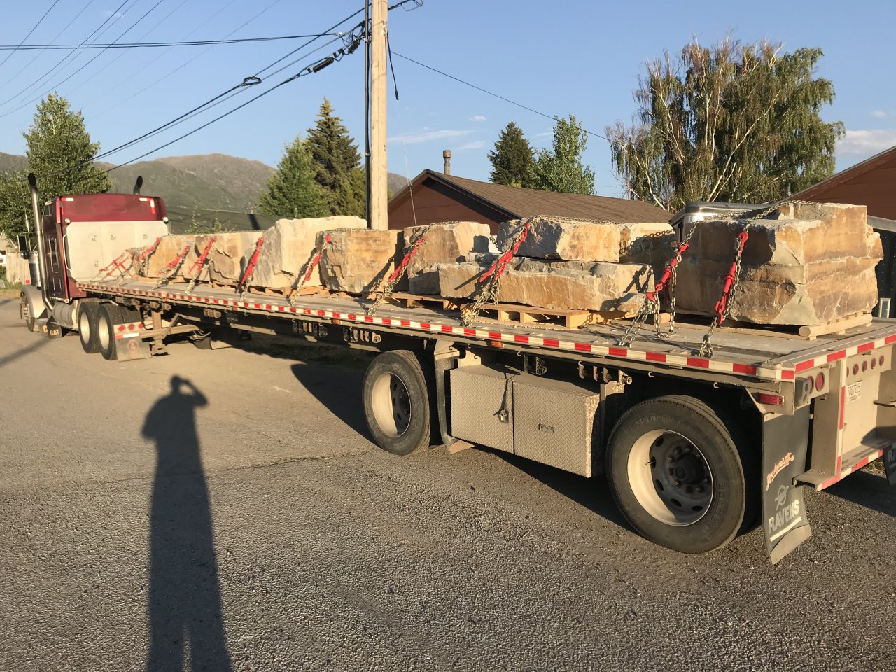

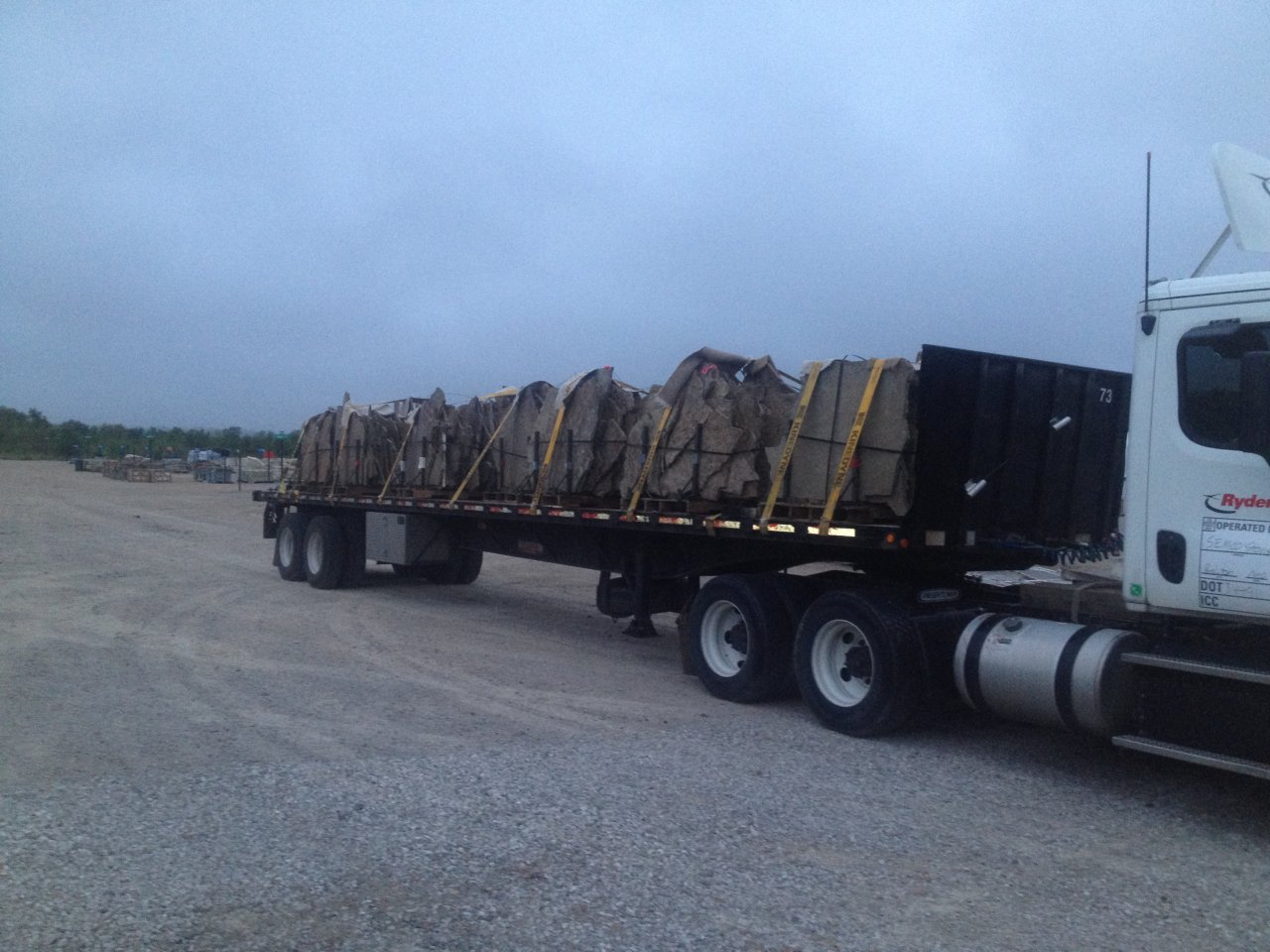

    Yeah those load were not to bad. I didn’t haul many of those since they came from to far away. But generally those pallets have a lean to them. We would load them so they all leaned toward the center and then strap them at an angle pulling towards the center. They rode fine.
    I had to talk many a driver off the ledge when I was loading trucks. Our rate conformation would say “stone” and everyone showed up expecting bagged gravel. Only a few actually left and refused the load.

    Brokers picture boxes of pet rocks when they hear stone. This is mostly what I’ve hauled of “stone.” I didn’t mind hauling that rock. However the shipper started getting ridiculous with the pick-up locations, so I stopped doing their loads.
