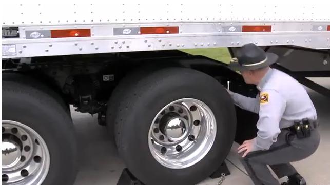

    See, he can't get to the inner one (going for the side door)? You're reachin'.
