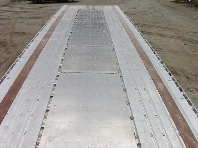

    I actually flew across the country to Western Trailer's factory to look at one. They're nice trailers but wouldn't work for what we needed so we ended up building one.
    Looks like the side boards on the one in the video are made of reinforced plastic for light weight which makes them look flimsy. The ones we looked at all had plastic covered plywood. They also didn't have the removable aluminum floor panels. Western builds very nice stuff but are very proud of them and they're price reflects it.
    They're made for a very specialized market. We wanted one to haul corn about 600 miles one way but bring flatbed freight back. (due to the lack of hopper freight for the return) The reason the Western Hopper Flats wouldn't work for us is we wanted to be able to haul steel coils and the Western trailers are outside frame trailers and will not haul concentrated loads. Also they only make them with steel frames and I hate to paint!:biggrin_2559:
    After looking at what Western had to offer we ended up building this.
    [​IMG][​IMG]

    How many bushel's can you carry with that setup?

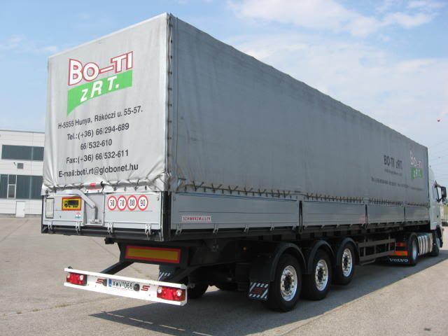

    here we use trailers like this
    they are 3 side tippers , also they can be completly opened and can load anything you want
    also we use truck +drawbar trailer combinations
    this one is most popular in this segment with bulk load
    but this setup is expensive
    for example look here
    http://suchen.mobile.de/fahrzeuge/s...&negativeFeatures=EXPORT&lang=de&pageNumber=1
    3axle 3side tipper trailer cost 51750€ which is about 73500 US $
    and this trailer dont even have alu rims or something special
    also there is few more expensive manufacutres ( and those red trucks above have all aluminium construction including trailer frame trailer body truck body and truck subframe also they have trapoulin and alu rims which raise price additional
    so in newer time more and more people buys setup like this
    this is lot cheaper comparing to straight truck+drawbar trailer combination ( 6x2 truck and 2axle trailer is particularly expensive)
    so lot of people buys
    setup like this [​IMG]
    only rear tipper
    or shorter trailer like this

    The trailer in the pic had 3 hoppers (one between the spread) and could easily do 1000bu. We made 3 of them and one was on a 96" wide trailer with 2 hoppers and it had to be almost running over to get a full load. We sold the last one last year and I believe it's in Texas now. Since the price of corn here went up considerably it became no longer profitable to haul it long distance. I believe the truck and trailer in the pics weighed just under 32k so it never needed to be filled full when running long distance. Just like the Western versions, they're very easy to convert back to a flatbed. In fact while the rear hopper was dumping the driver could have most of the front half torn down.
    Another option Western offered was a "walking floor flatbed" which was really neat but again wouldn't work with concentrated loads. You could walk any load right out the back of your sidekit.:biggrin_25514:
