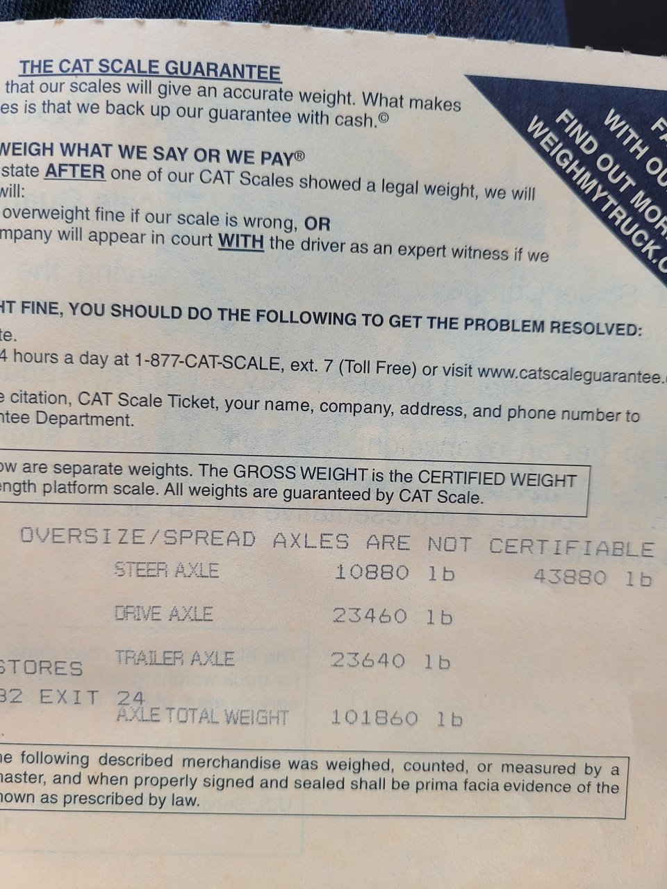

Does this scale ticket look right? Scale not functioning properly?

    How heavy do u think you are? They messed up something. The 43xxx in the right column is going to be ur rear axle weight after u pull forward to get the spread axle weigh. The trailer axle will be ur front axle. Looks like you did everything correctly but all the weights are wrong. Maybe a damaged scale or out of calibration.

    Yea. Just pull on and get the total weight in one go. It will tell you if you are over your 40k on the spread or not, but it won't tell you if you are over 20k on a single. As for the procedure to weigh a spread, I'm hoping someone that does it can help.

    I usually just get normal weigh . but you did it correctly, just the scale printed the wrong weights is what it looks like. I would try to find a different scale to weigh out at.

    And, of course, demand a refund as they obviously can't do it correctly.

    I find it hard to believe that one axle on your spread is 23,xxx and the other is 43,xxx. I am going to guess you didn’t quite get them on separate platforms when you did your split weigh and that 43,xxx number is the total weight of your trailer axles. Hammer down!
