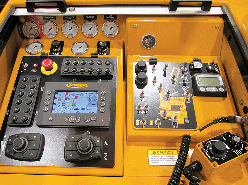

  6. TripleSix
    19,179
    134,072
    I think what gets lots of them are the joysticks instead of a steering wheel. At the places where they load, if its a machine I am unfamiliar with, I will ask for a quick rundown from the loader.

  9. johndeere4020
    8,522
    119,296
    Jan 1, 2010
    That's a Gomaco control panel, probably a 3600 since it only has three tracks. once you figure it out it's pretty easy but it has a couple of stupid safety features. First time I moved one it took me a minute to figure out that in low range you have dial it to about 20% before you notice it moving.
  10. RGN
    RGN Road Train Member
    1,644
    17,360
    Jun 13, 2014
    I figured you might be the one to spot it- 3600's. Nice guys where I loaded the old ones out- showed me what was what. Even gave me an air fitting after I tried to pull 38' of the trailer forward with the neck using the air lines.
  11. not4hire
    not4hire Road Train Member
    7,142
    26,958
    May 16, 2012
    Calgary
    It's nice to see they have one of the buttons marked "Run like hell..."
