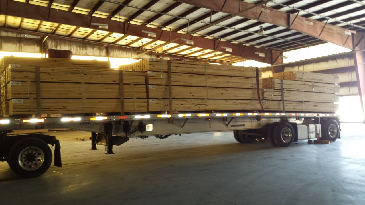

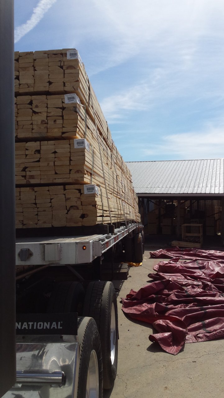

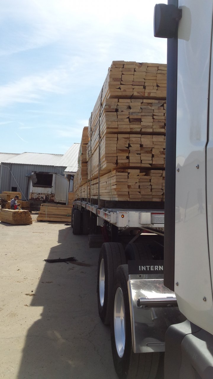

    I'll put 2 going one direction. And 1 in the middle going the opposite direction. Straps pulling from both sides help from shifting. But yours shifted from the opposite side of the strap pull. Even if you split and strap the teirs. I think you'd still end up with a shift. Them loads just flat out suck. You don't need a car to cause the problem. The curvy roads do that too.
    I had one that shifted bad enough. I had to drop the trailer. Bring the truck from the side. Hook straps to the truck frame and pull the load back in to position. Luckily that load wasn't tarped.

    Live and learn.. It certainly shifted but it doesn't look too bad.

    As has been said before by these FB guys, you can over-secure a load many times and spend the extra time, but you can under-secure it once, and lose all your time.
    That didn't look like that bad of a shift, O/P ... bad enough to be concerned; i'm sure. Thanks for sharing.

    The thing is, excrement happens, but on the bright side you had enough securement to keep the load on the trailer even though the load shifted.
