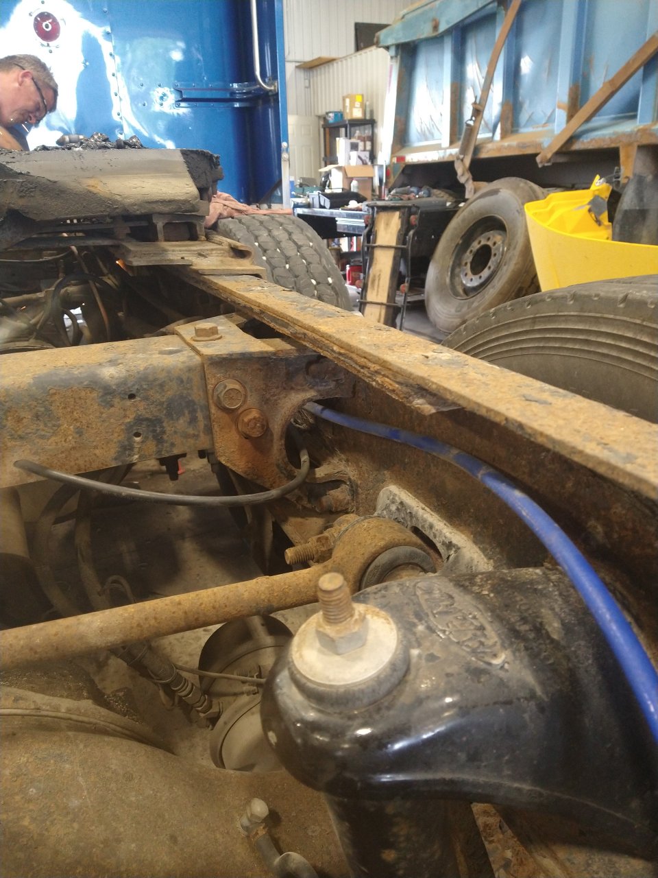

    IMG_20220809_172854748.jpg lf you look close you can see how the frame rails are opening up and tilting the fifth wheel slides etc. Plus the suspension hangers on the Pete seem to collect water and rot out the frame rails too

    Double framed trucks up here do ok until they get around 15 years old. By 20 it's rare but to have those issues. Not saying you can't find ones that aren't in really good condition. But in everyday work trucks it's hard to find one that 20 years old without similar issues.
