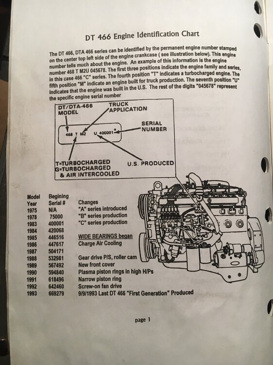

  6. AModelCat
    29,723
    165,039
    I've done a few injection pumps on B series DT engines and they were all Ambac rotary pumps.
    The C series DT's I've come across were inline injection pumps. I found a service bulletin a while back that Case started using the C series engines in their ag equipment sometime in the early to mid 80's and that one of the changes from the B to C series was the switch to a Bosch inline pump.
  7. ElmerFudpucker
    7,082
    77,503
    May 17, 2024
    I have never heard of a B or C DT. I know B&C Cummins. 3.9/5.9/8.3. The DT is an international engine DT 360/444/466/530. I have never heard of them referred to as B or C.
  8. AModelCat
    29,723
    165,039
    917FCD93-D3DD-4F98-B5C5-30FB524CF8CD.thumb.jpeg.13f57c1fce92fff9c44f933de9657960.jpeg.jpg
    ElmerFudpucker Thanks this.
  9. ElmerFudpucker
    7,082
    77,503
    May 17, 2024
    Interesting. I have never seen or heard of them referred to this way. Learned me something new today.
  10. AModelCat
    29,723
    165,039
    I believe they made an E model at some point as well.
    I didn't know there were B and C models until last summer when I pulled an injection pump on an old TD15 dozer and the service book refered to the engine as a DT466B.
