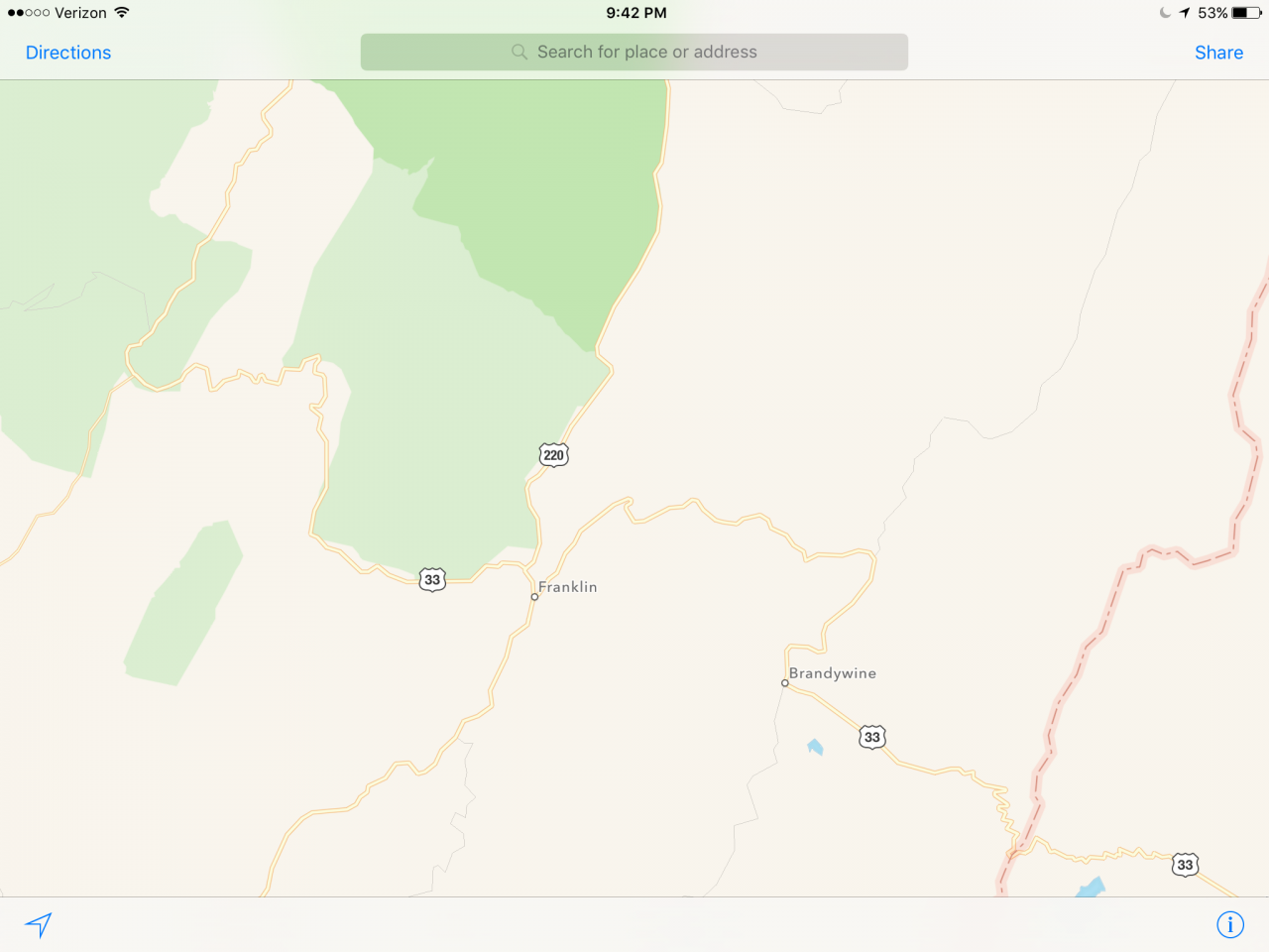

    Well crud.... NOW you tell me that... I thought the cartographer just had a hand spasm at that point in making the map. Ugh.
    Guess I better look a bit more closely next time.

    If the cartographer has palsy, then beware.
