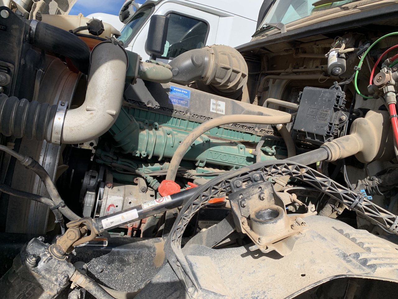

    Hi I need to know what the black cover on my engine black is ??
