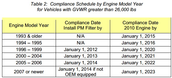

  11. double yellow
    double yellow Road Train Member
    5,945
    10,066
    Aug 28, 2011
    State of Jefferson
    as of July 18, 2014: http://www.arb.ca.gov/msprog/onrdiesel/documents/FSRegSum.pdf
