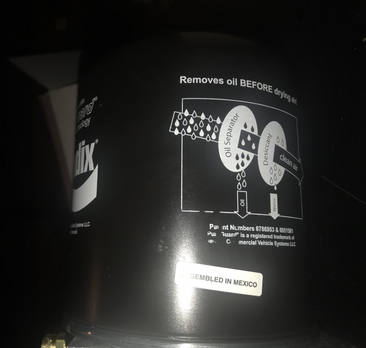

    I now remember that my air dryer filter is capable of separating oil and water. I took a picture of it a couple months ago while I was replacing my entire air dryer/governor. My previous company would replace the air dryer filter along with doing a power steering oil change every year.
    Huh. It just occurred to me that the reason these systems are called air dryers is because they dry the air in the system!? How did I miss that.
    I found a Bendix document saying that reservoirs (air tanks) still need to be drained every 25,000 miles or 3 months (whichever comes first), and the air dryer filter needs to be replaced every year.
