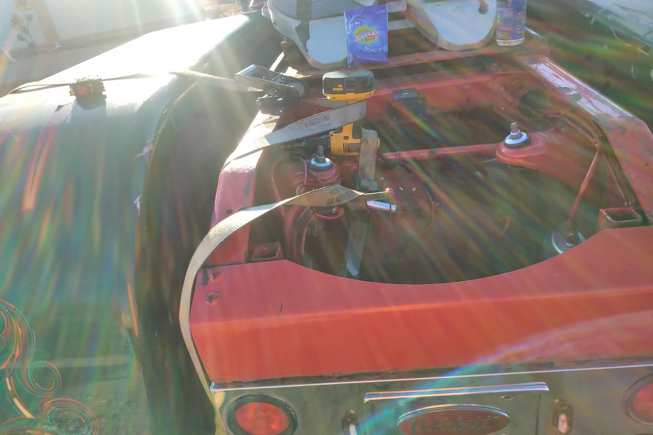

    If you want to make a poor man's mag drill you can rig up some ratchet straps so that it's pulling the drill into the frame , then as the bit works its way thru, you just get another click on the ratchet and keep finger on the trigger and let the drill do all the work..sure beats pushing against it with all your weight.. I start with a 1/4 inch bit to a 3/8 to 1/2.. Slow and steady ..
    I just got done drilling out the frame for some frame ramps... I drilled from the inside to avoid taking the fenders off, but it could still work doing it from the outside..

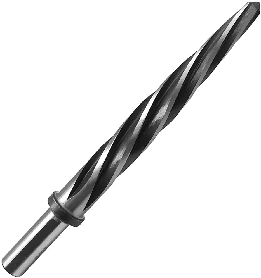

    The fluted reamer bits are a lifesaver and 3/4" hand drills should be illegal.
