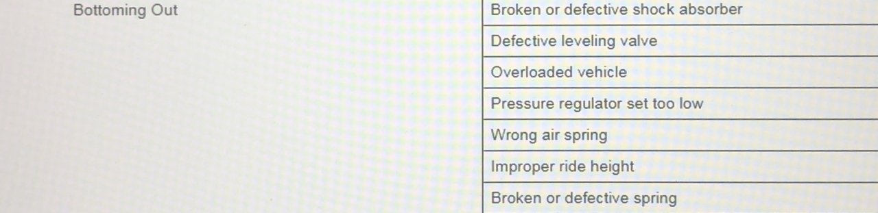

    thats an awesome pic,
    my shock absorbers are older, but the issue is when im at a dead standstill, it bottoms out before i even go anywhere.
    - i put a new leveling valve on, also had the old leveling valve inspected/adjusted prior to replacing it
    - anything over 35-40,000lbs it bottoms out even with 5th wheel adjusted
    - pressure regulator is set at 130psi now, previously it was around 110
    - wrong air spring? as in bags? they all are stamped volvo and look oem (if not original lol)
    - improper ride height ---- i'm agreeing here
    - springs looked fine, didnt see any bends or breaks or abnormal ware after getting under it again today. it seems i spend 6 out of the 7 days under this thing :( drives a man to drink.
