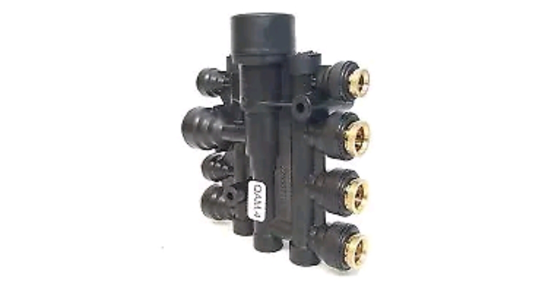

This manifold airs up the 5th wheel slider; air horn; air bags and transmission splitter. When it sticks all those items just dont work. It's a fairly cheap part but try the leveling valve first.
Did you buy the truck from Arrow?Johny41, newdriver2 and PE_T Thank this. -
I was going to say the same thing from looking at the pictures. I guess it’s starting to make sense now. Someone mentioned to place a PSI gauge on each airbag to check all airbags are receiving enough air pressure. Maybe an air line is bent or damaged. Also check your air dryer. The air dryer filter needs to be changed every year. The filter helps remove oil and water from the air system.newdriver2 Thanks this.
ironic that you posted that actually, when i first bought the truck from VanGuard (Mack) that valve was cracked/broke/leaking/a mess...i replaced it with the OEM one for $70 and it was located inner rail driver side twords battery box (bolt behind batteries that held it in)
but I replaced that when i first bought the truck about a month in a half ago.
