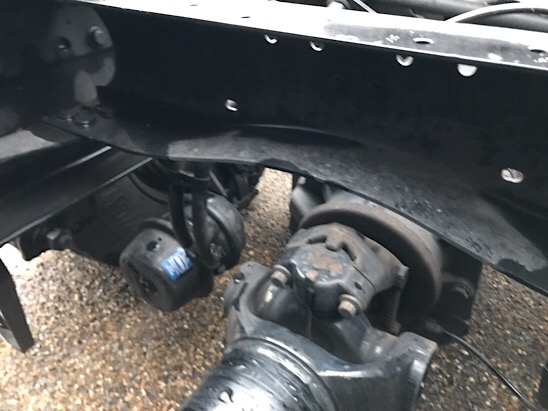

    This is the amount of space my 780 has over the u-joint.

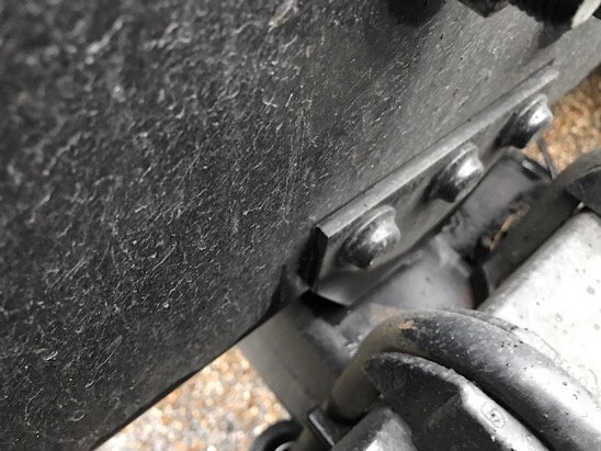

    Make sure the bump stops are still in place on the outer edge of each axle tube. They are bolted to the outside of the frame rail with three bolts. There are four of them... just a piece of stamped metal about a quarter inch thick.

    By the way... the u-joint pic is with my bags dropped, axle tubes touching the bump stops.
    daf105paccar and newdriver2 Thank this.
  11. newdriver2
    newdriver2 Light Load Member
    97
    87
    Sep 14, 2017
    Yea I have maybe 1inch with bags dropped between the shaft and the cross member ...with a load maybe 3/4 inch
