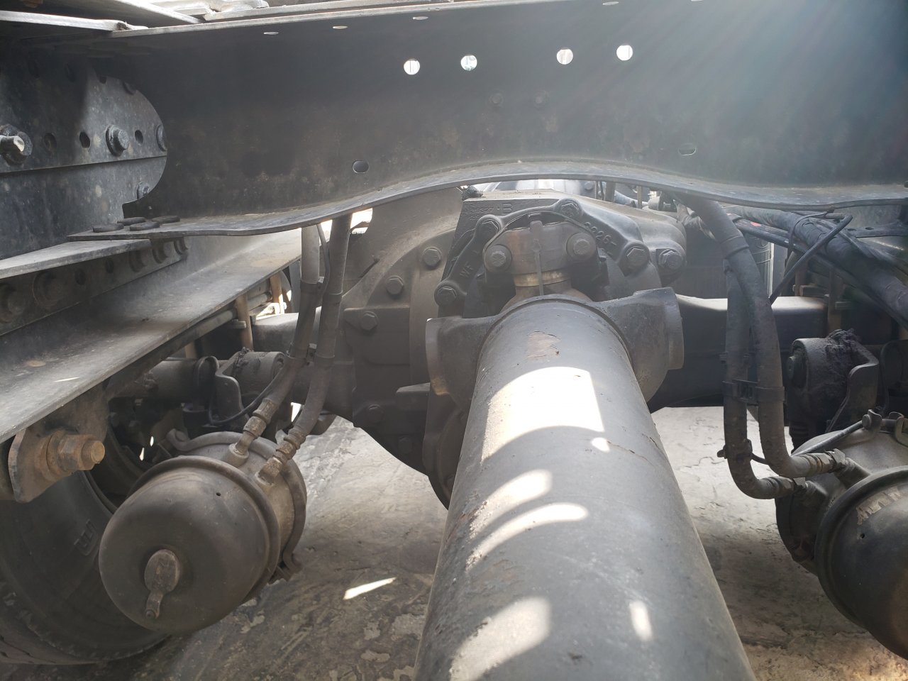

    Checked my bump stops they are all 4 there, they do not look damaged *
    The axel is a slide axel (maybe the wrong terminology) I'm going to drop bags an see if it moves after I drop my 6k load off
    * I turned my air up to 130 psi, it floats between 115-130
    * I'm going to swap leveling valves here and spray my bags also tonight

    Took some new images just now with a light load. The axel is 1 3/4th inch from touching that cross member current with a empty 20ft box. Tare weight is around 4.5k +/-
    Frame seems like its sitting high compared to other trucks in my yard.
    I also got the service history this morning on the truck from the old company which owned it...
    I screen shotted previous drivetrain related work...which was done 70k miles ago including leveling valve and axel an yolk
    - final note on the service history was driver stated truck was not safe to drive, notes in description that mechanics inspected front end for 2.5hrs and never notated or serviced truck afterward several thousand miles ago
    daf105paccar and Johny41 Thank this.

    So I just looked at my 2010 and the crossmember has an arch in it. I am parked and bobtail
    KB3MMX, newdriver2 and Johny41 Thank this.
    KB3MMX, Johny41 and newdriver2 Thank this.

    If the axle is sitting on the bump stops and the yoke is still too close to the crossmember, the only thing it can be is the angle of the rear axle. Check to make sure somebody didn't put shims in backwards. Then ujoint angle is probably way off.

    Interesting, they fixed the older poor engineering on 2010 models, mine is 2010 but i have U shaped aluminium crossmember. I used to have same crossmember as OP on my 2008 model, on truck i puchased/built in 07, and it touched the driveline. If you look around in truck stops at older volvo models most likely have same isues as springs get weaker or air leaks.
    Here is one used for 200$, looks dimilar, change the crossmber, cutt the huck bolts and if you don't have huck gun, you can use grade 8 bolts, any volvo shop has them as replacement option for hucks.
    I still believe you have air leak problem ,weak torque leaf /loose u-bolts.
    volvo truck 2007 crossmember - Google Search
    Btw, I have this older photo on my phone, as I said it's hard to find cracked torque leafs like this, have to look from underneath.
    Btw, I watched this videos about huck 360, you'll find different sizes would work better to replace the crossmember without the need for huck gun. They can get tightened with any impact wrench and are five times more vibration resistant than regular nut bolt fasteners, same like huck bolts,
    Huck 360

    Thank you, I might actually just swap out the cross member honestly and fix the air leak wherever it is. I'm going to inspect the springs also. I'm going to power wash the springs off here short and start on it.

    The rear axel when bags are inflated is sitting weird. The whole rear differential sits almost at a angle like its pushed forward
    When bags are dropped the rear axel sits normal however the front drive shaft is still very very close to the cross member

    I just drove to the dealership I gave them my Vin and I wanted to check the cross member.
    they had it in stock and on the computer sure enough… their computer diagram shows that the cross member has a curve in it so we walked back and grabbed the cross member off the shelf and it's a new design with the curve
    KB3MMX, Rideandrepair and PE_T Thank this.

    Wow. So it’s possible that the truck has had that problem since the new drive shaft was installed in 2016. The previous driver couldn’t figure out the problem and decided to sell it without telling the dealer. The dealer mechanic may have done a test drive, but the truck wasn’t fully loaded, and they didn’t notice a thing. It would be interesting to know how many people have owned that truck and sold it because of that problem.
