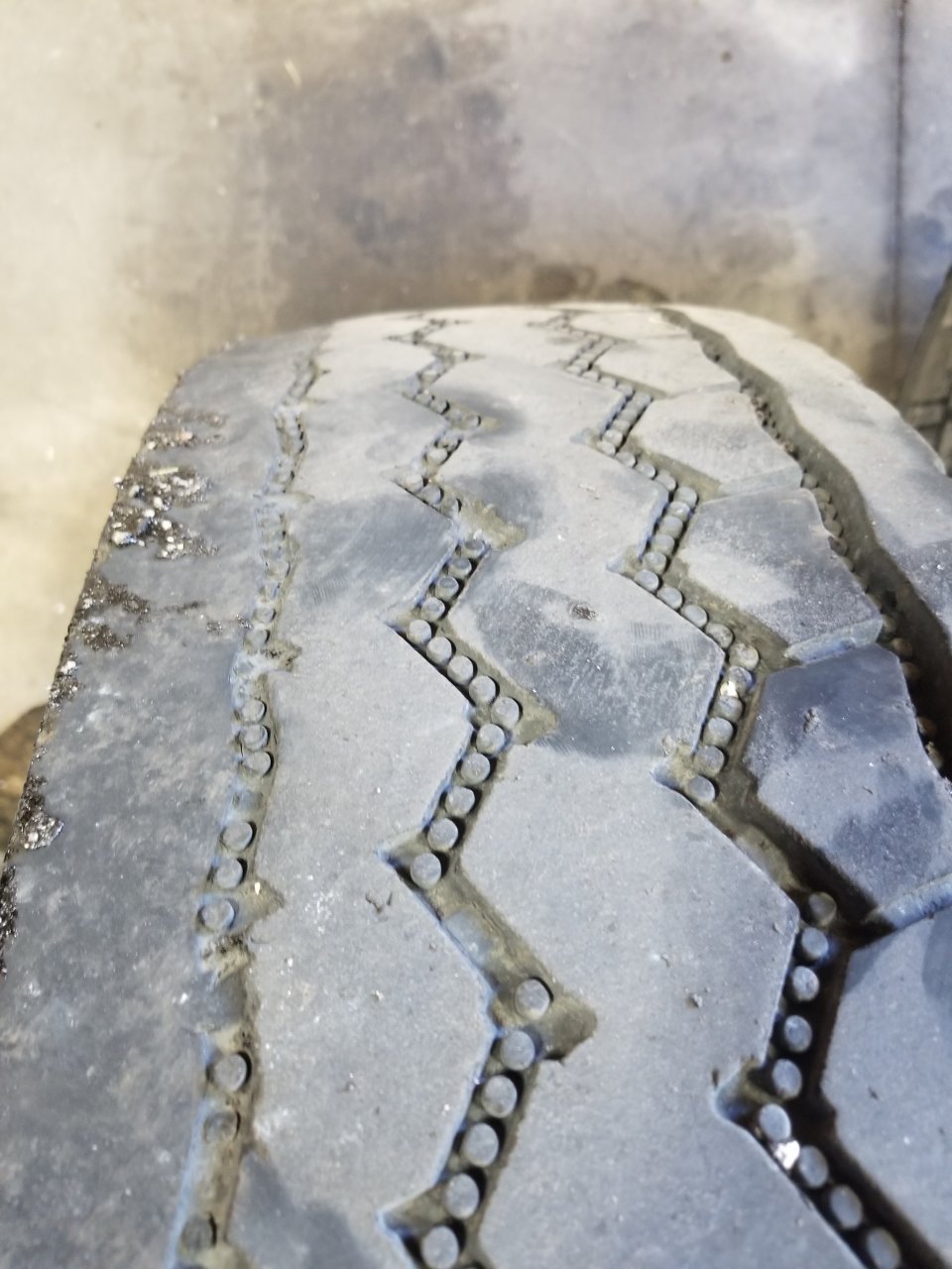

    Need help to figure it out, All 4 inner drive tires recently started showing just the very inside edge wear, other then that all tires look wearing uniformly with about 9/32 left on them.Those are original tires on 2014 volvo vnl with 260k miles. In the last 6 month truck had been 3 axles aligned, all shocks replaced, and a few weeks ago leveling valve replaced did not see any funny wear at that time. Thanks

    Looks from pic. that the rear wheel bearings need to be adj. back to to spec.

    I was going to guess wheel bearings also.

    torsion bar bushings?...maybe?

    Thanks for your inputs, Will start with checking wheel bearings it just seems odd that all 4 wheel bearing went out of specs at the same time. but i guess it is possible that they were not set right from the factory. Have to have it fixed before i invest 4k on a new drives. Will keep you guys updated

    All my bushing are new polyurethane. Must be a bearing

    Mine does this. Currently at the shop getting all new bushings and alignment

    As I said...my money is on the bushings..
    Your comment above is a strong hint that it's not bearings
