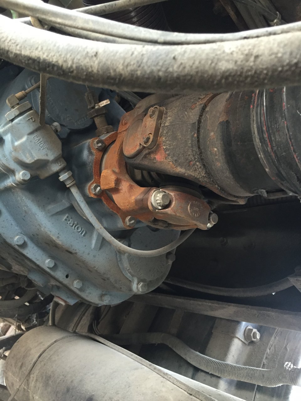

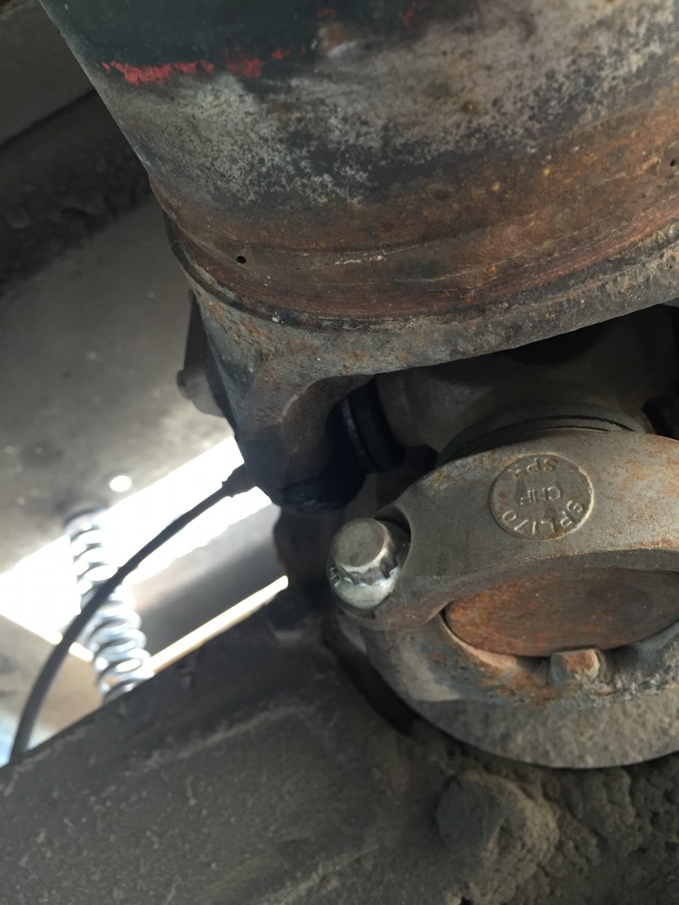

    NM I looked at the truck today, looks like they cut the differential side only.
    Since it's already a short drive shaft (day cab) there was no carrier bearing to check if it was shimmed down.
    There were new weights welded to both ends of the drive shaft. image.jpeg Diff end
    Trans end
    AModelCat Thanks this.

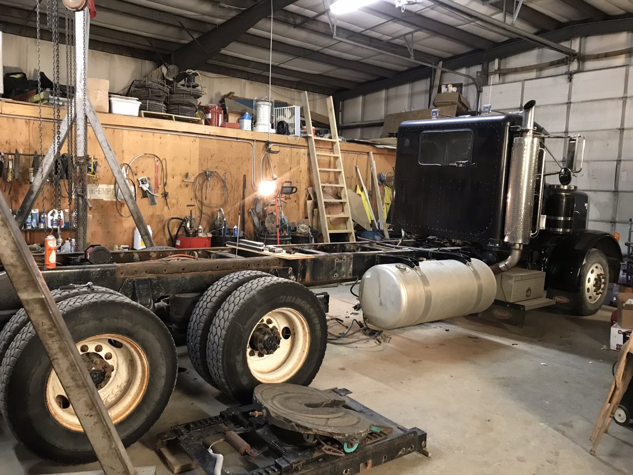

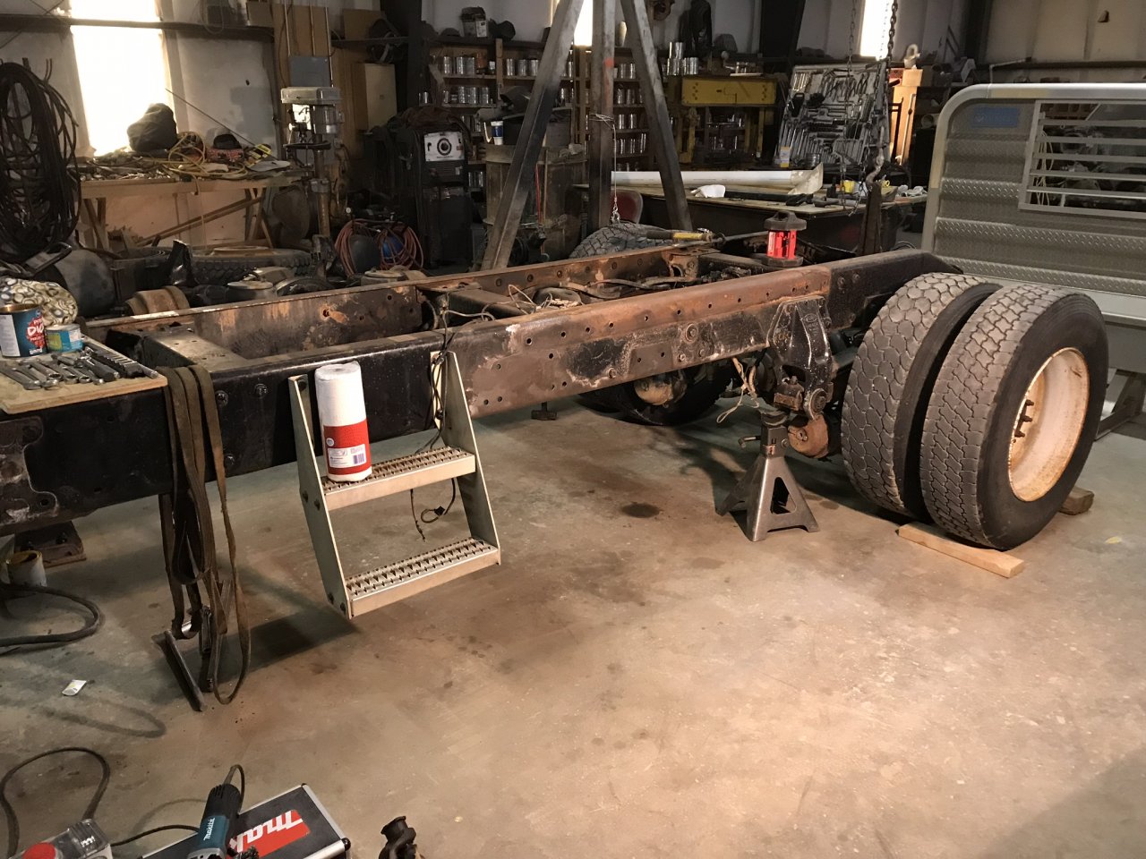

    7B7B4382-6616-4E74-8CB0-6BBC9D7447F0.jpeg This is an older thread.... how did things work out AModelCat? I’m currently in the process of removing the forward axle and sliding the rear drive forward. This is on a ‘99 Pete with air leaf. 348311D8-D1B1-414C-805A-C34D517416F9.jpeg
    Oxbow and AModelCat Thank this.
  11. AModelCat
    29,732
    165,108
    I got sidetracked and didn't get the diff in until last summer. I ended up just putting the diff wherever the driveshaft lined up at. I went from Hendrickson rubber block to Airliner on mine so it wasn't as easy to just move it up to the next set of holes.
    SAR and Oxbow Thank this.
