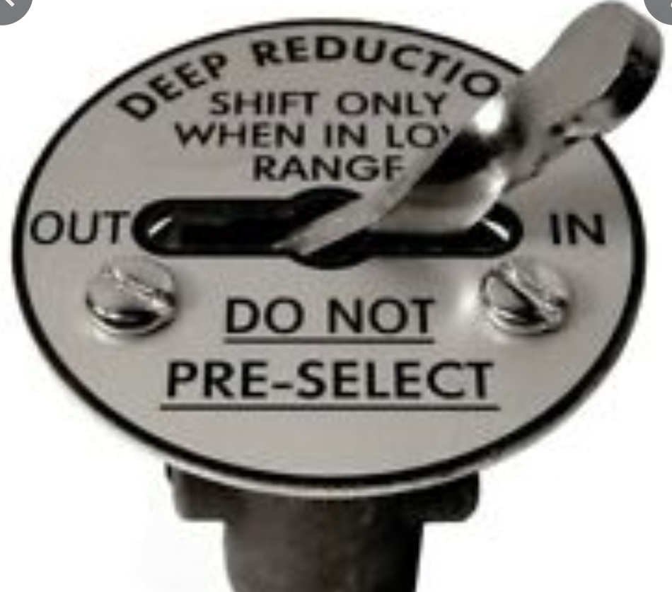

    I bet the toggle was made of a twisted piece of flat metal, wasn't it? I believe it was KW who used to put them in the top surface of the dash, but could be wrong on that.
  3. AModelCat
    29,620
    163,801
    I believe you are correct

    It was..
