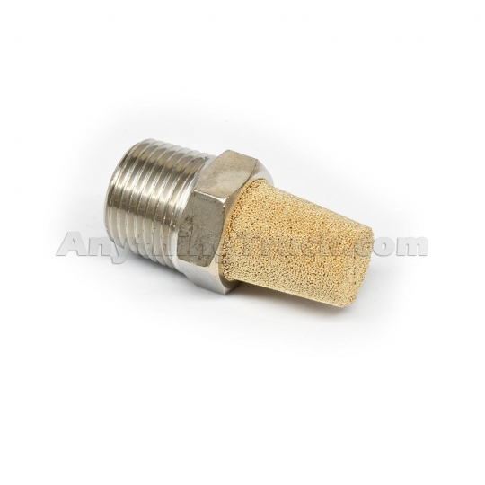

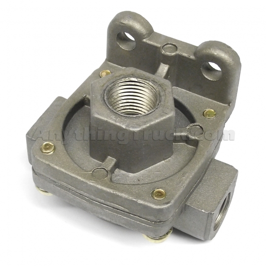

  7. Star Rider
    Star Rider Road Train Member
    1,808
    19,313
    Sep 23, 2019
    Michigan
    If you have these little mufflers on your valve pull them out and try. They can plug up and not let the air release.
    Also check if has QR valves plumbed in that are sticking.
    OldRed98 and Rugerfan Thank this.
