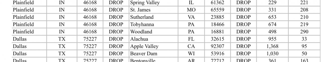

    How do the mega companies make things work with drop trailers on both ends? If there is no back haul to the shipper then how does this make sense?
    How do they get drop trailers into the receiver without wasting a ton of time and money? Same with the shipper?
    Do they do power only with other megas to get back to a terminal? Are loads like the below pic only work for companies that have terminals near pickup and drop off? So, they wouldn’t bid on all lanes just what is close to the terminals to minimize cost of getting started?
    I don’t get it. For small fleets and single operators I’d think live and live or drop trailer just on the shippers end is possible?
    Here is a pic of a very small example of a company I’m quoting. They do have some live/live but vast majority is drop on both ends.

    What I’m saying is if you need 15 drop trailers at 1 location that ships a ton of loads. 15 in another location that ships a ton of loads. Then you need 2 drop trailers in 30 other locations that receive loads. How does it make sense to place all of those trailers? I’m not even talking about cost of the trailer. I’m talking about all of the one way moves all over the country to get them into place?
    For some reason I’m having trouble describing this. Basically those trailers have to come from somewhere and get into place to start the flow of business. Wouldn’t it cost huge amounts of money to get those units into place? What about then if you lose the business and now must take them all out?

    If you look at the pic that’s about 5% of the lanes. The last column is yearly volume. Say you put 20 trailers in Plainfield, 20 trailers in Dallas. Then you gotta out 2 or 3 in WI, PA, CA, etc etc. No freakin way can a small company 1: have that many trailers, or 2: Do one way trips to get a trailer in place then bobtail all the way back home.
    That’s why I wondered if maybe companies collude together to haul each other’s trailers that may need moved. For example I haul a loaded trailer I own to CA and then get a power only back to the Midwest.
    This is such a scale it’s hard for me to fathom. I get a couple drop trailers locally but wow drop trailers all over the country is a whole another deal and the money it must take to just get started.
    I’ll stick to my live/live or maybe a couple drop trailers just locally. This is a whole another ball game us small guys can’t even begin to compete.
