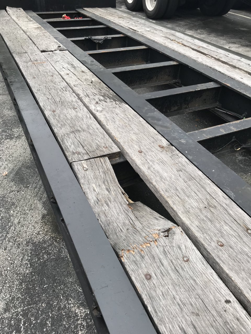

    Already broke a board. I picked up a pushback tractor(not pictured)...one of the things they use to push the airplanes around from the Birmingham airport and that thing was only about 8-9 feet long but HEAVY!!!! Im dropping trailer tomorrow to re-do the whole deck. Well hopefully if we can find the oak. It'd cost over $5200 to redo the whole well in Apitong(including the center)

    That cross member spacing doesn't lend itself too well to heavy wheeled equipment.
    We mostly haul heavy solid tire forklifts. Our Talbert RGN has 12" spacing and even then the boards flex a whole lot with our biggest lifts (around 70K). We ended up haveing to replace the boards with channel iron where the forklift tires run. The close crossmembers and channel iron makes it heavy but it's what is required with our line of work. If you ever have a 70k forklift fall through the floor, you've got problems.

    Especially if it falls through the floor while your are going down the road.
