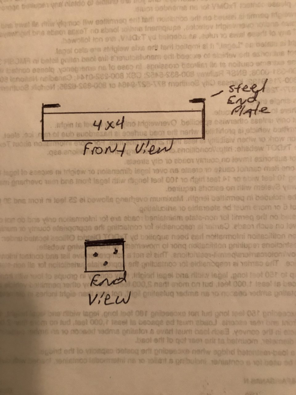

  5. kylefitzy
    kylefitzy Road Train Member
    4,755
    19,812
    Aug 12, 2007
    Kansas city,Mo
    I was parked next to a guy who had a set up just like this. That’s a good idea if you keep the same trailer all the time.
    cke Thanks this.
  6. soloflyr
    soloflyr Medium Load Member
    563
    1,688
    Nov 6, 2009
    Houston, Texas
    If I worked for a company that had me constantly using different trailers, I’d present the idea to the boss to have it on all the trailers. Appeal to their boss like senses, it’ll save money by not having boards walk off, & it would be safer as the board couldn’t kick out from under the neck.
    The first part is a common problem, the second part is more rare, but I’ve seen it happen.
    cke, Oxbow and kylefitzy Thank this.
