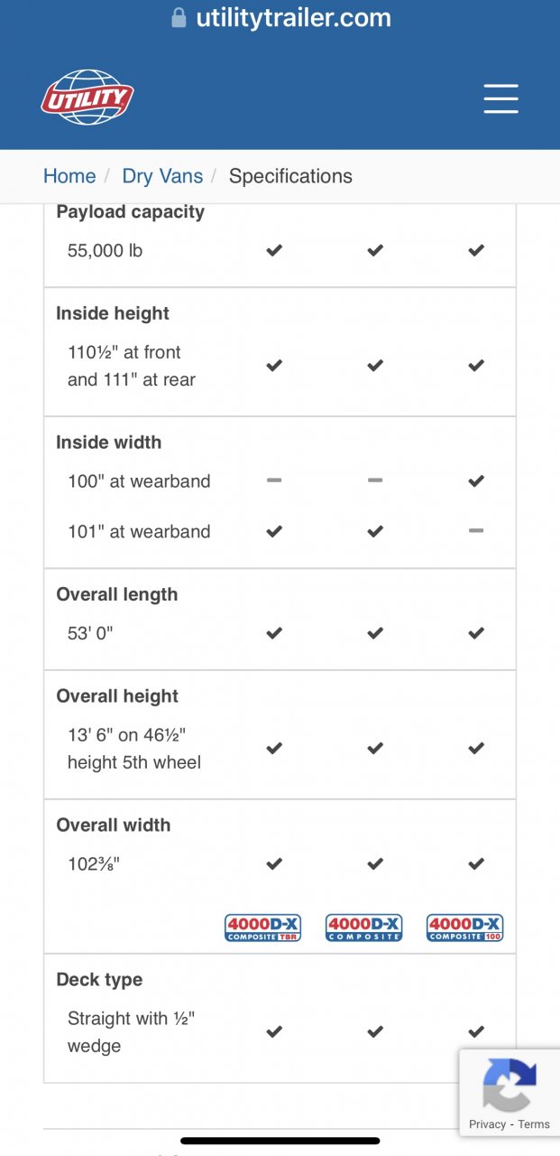

    It MIGHT be 101” wide if they have a protective runner along the wall parallel to the floor. The inside wall to wall might be 102”. I’m not sure what measurement the new trailer you’re looking at is advertising; from the wearband or wall to wall.

    My Utility is 101.5" inside. The main reason for being asked for 102" inside is for can loads. Most general freight will not have any issues and they are really trying to stop people with the pull down doors since they are under 101" inside.
    When I ran a shop and shipped stuff out I would make sure that the broker knew this information because some Joe blow junk trailer would show up with pull down doors. We custom made skids and had to have the 101" to fit them in the trucks for what we did.
    If you do any amount of Can loads than I would make sure you get the 102" inside.
