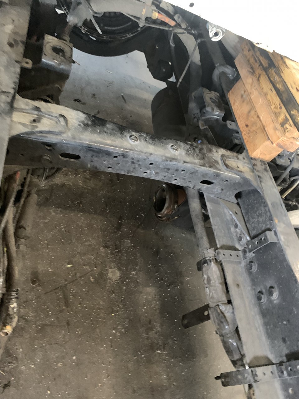

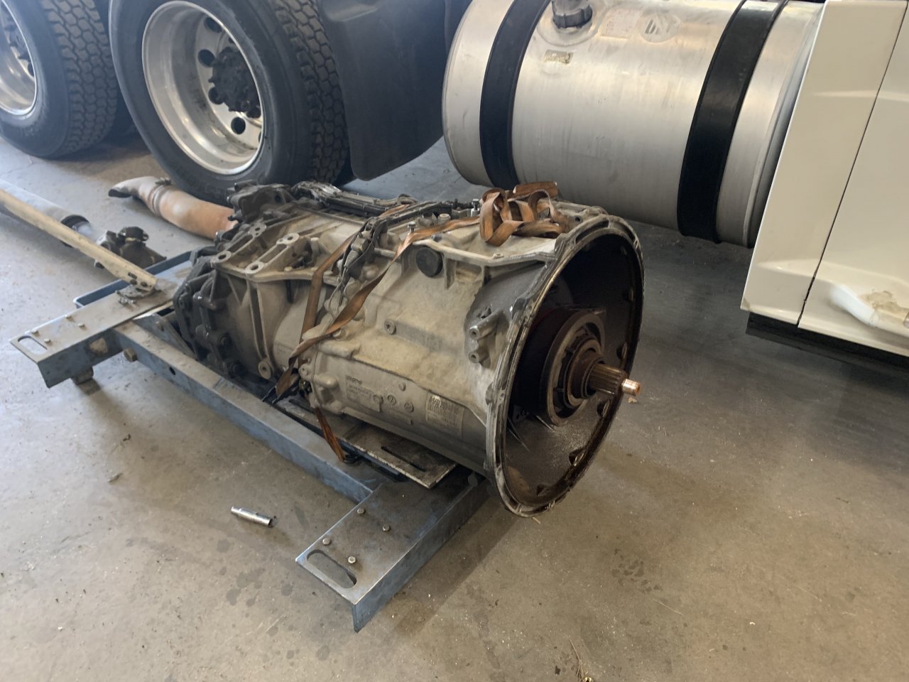

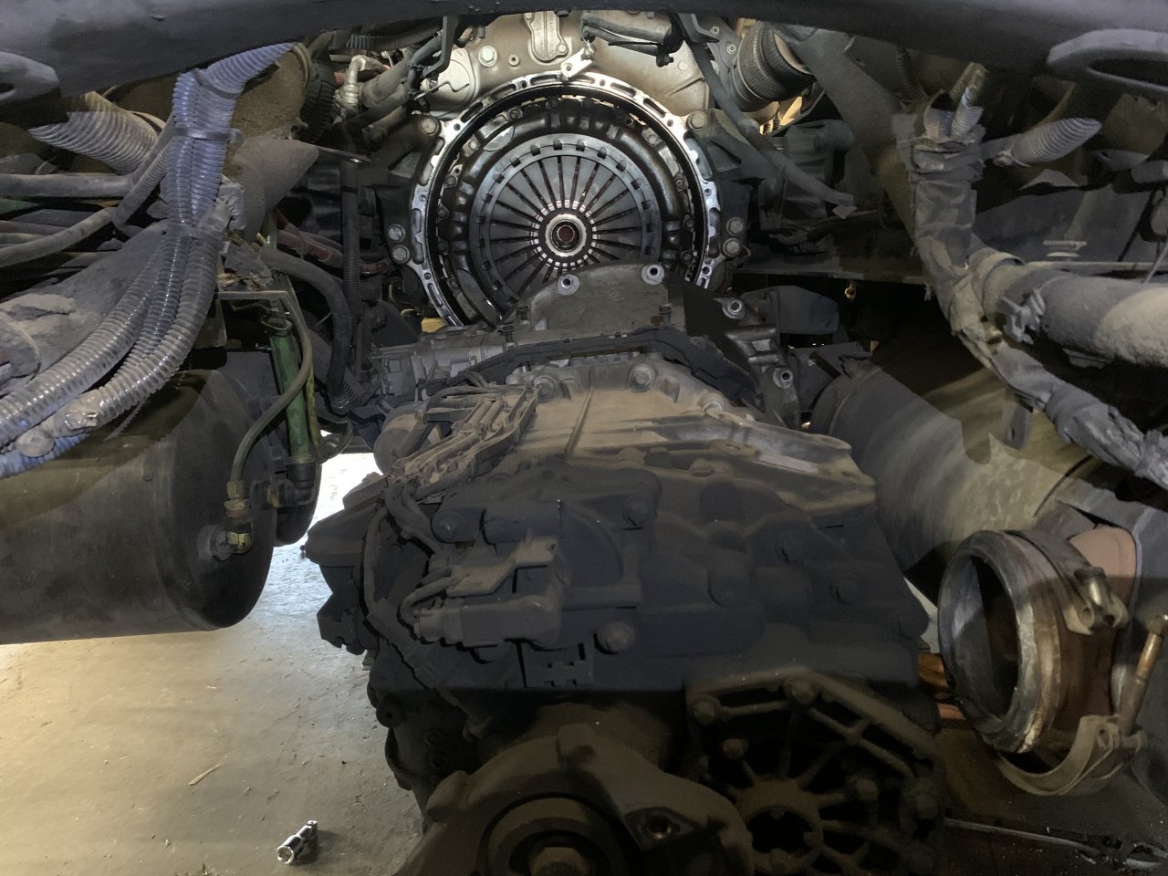

    Dropped it yday, was a pain with the side shifter offsetting the weight, had to remove the air tanks and everything behind it to lift it out with a forklift, is there going to be physical damage I’ll see to the split pin?

    There shouldn't be damage to the pin. Its just that the aluminum bore that the pin slides in wears, and causes the pin to stick. The technical service letter I attached has a part number for the kit you need. If it's the old style, you have to drill out the hole to accept a steel bushing.
