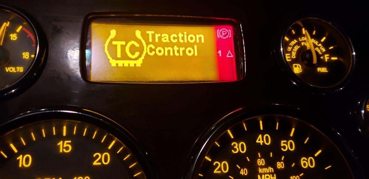

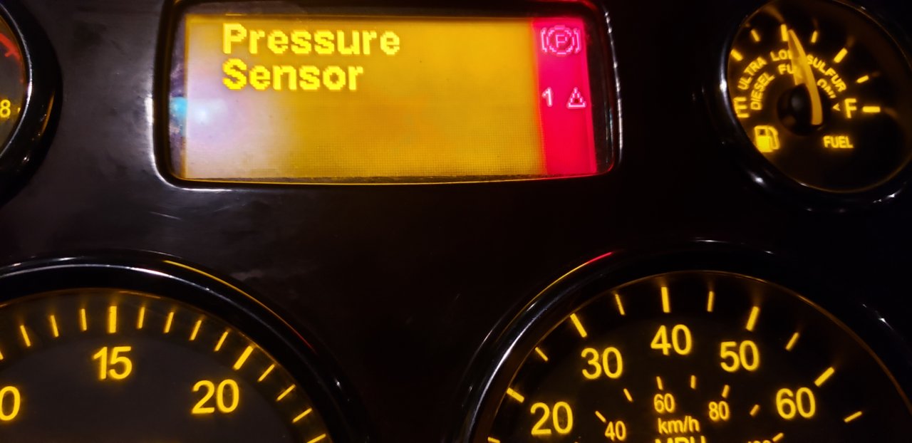

    My traction control light has been stuck on the past couple weeks. Scrolling through the fault code list it shows pressure sensor also. Are those correlated or am I looking at two separate issues?
    Surprised that my cruise control still works with the traction control light on....

    Get bendix ACom hooked up. Possible ABS faults due to pressure transducers/ correlation. Be on the look out for any major air leaks, tractor trailer or other wise.

    Mine just started doing it. What was the fix?
  11. JonJon78
    JonJon78 Road Train Member
    7,245
    43,256
    Jul 1, 2018
    It was the Air brake pressure sensor. Part # 6CP3-17SVC
    I had peterbilt do it, because I didn't know the problem obviously, but that sensor is located inside the kick panel. Just needs to be unplugged and plug the new one in... Sensor cost $235 for the part.
