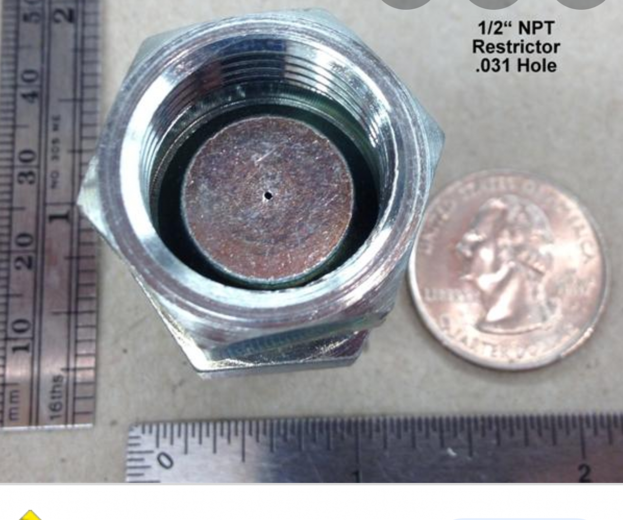

    Also a peanut just looks like a normal fitting, but when you undo the fitting it only has a very small hole for the fluid to pass through... I didnt even know they existed until I discovered one while trying to figure out a similar problem.

    This is a good picture of what I have called a peanut..
