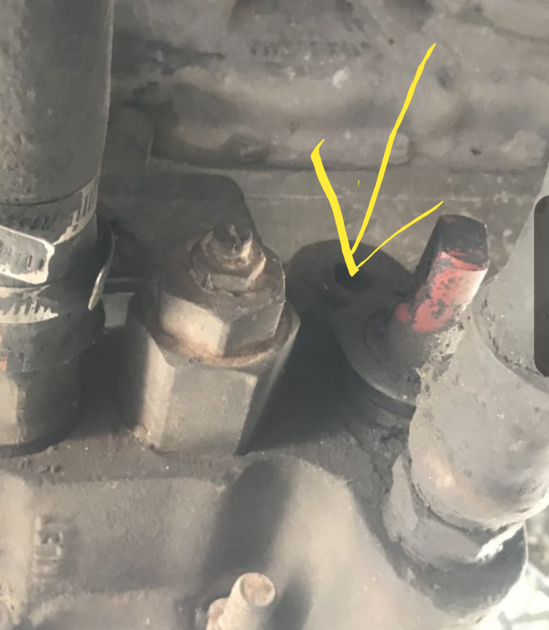

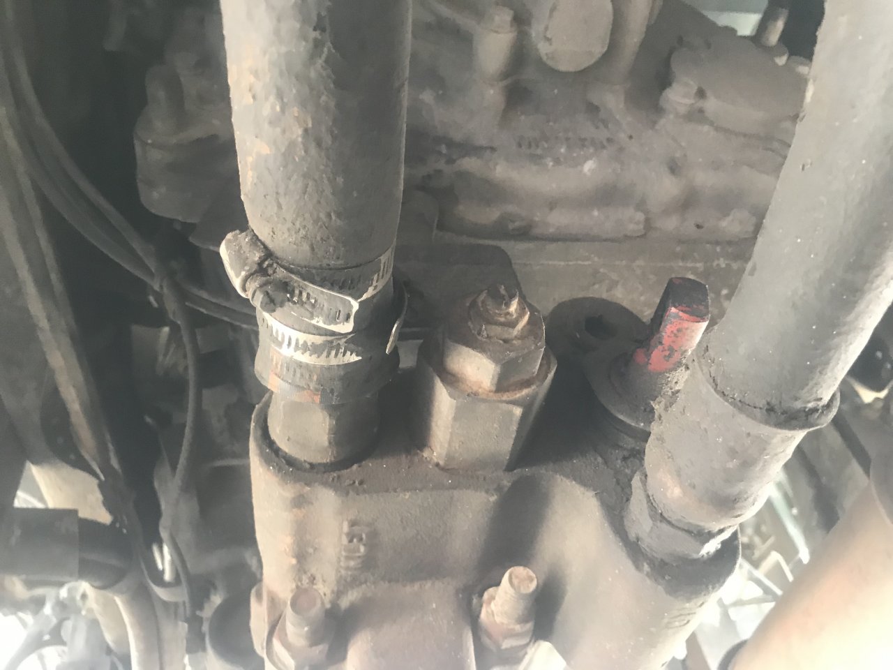

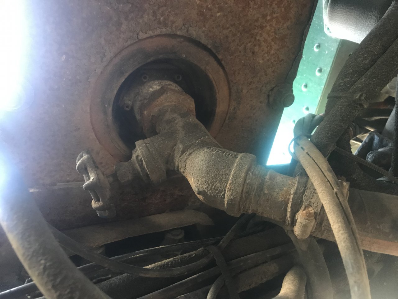

    So I took a few pictures, there is a turn knob valve on the bottom of tank. I don’t see how the fluid can go any other way besides back through pump to tank.

  3. Cattleman84
    Cattleman84 Road Train Member
    10,054
    71,925
    Nov 1, 2017
    The Sticks, Idaho
    The rear portion of that pump is the valve... It is built right into the pump itself.... I would start by checking out that the linkages between the cab controls and that valve are not worn causing excessive slack in the linkage. Excessive slack in the linkage could cause the valve to not fully move to the return position, which means it is only partially opening the return port inside that bypasses the pumping gears.

    If that's the only line from the tank, then yep, that should be a control valve on the back of the pump. I've never seen a setup like that before. Pretty slick. Who makes it?

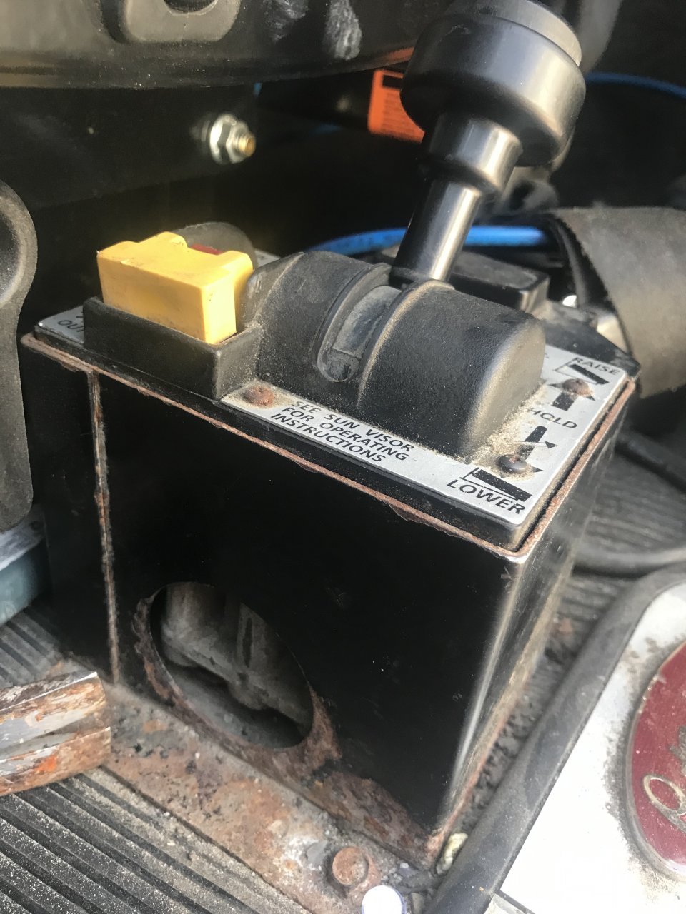

    The PTO automatically shut off when you go to lower the box. I don’t personally drive this truck, I just own it but when I just got in it and went to lower the box the control box where the level is I hear a small air leak/hissing EB35FA52-6B1F-4F09-9D5E-7EBE4101BE26.jpeg and I’m guessing that’s the actuator you’re talking about ?
  10. Cattleman84
    10,054
    71,925
    Nov 1, 2017
    The Sticks, Idaho
    That actuator probably looks like a very tiny hydraulic ram... And is probably right on top of (or maybe built right into????) the pump/valve.
    Actuators come in hundreds of sizes and styles but here is a picture of a more common design...
    It is probably connected directly to that oval piece above the right side hose in the pic you posted of the pump.
    Samot Thanks this.
  11. spsauerland
    spsauerland Road Train Member
    4,296
    10,891
    May 31, 2010
    West Harrison, In
    The silver aluminum box shifts the spool valve. Have someone shift it and watch that spool is making full travel or take air shift cylinder off and manually shift it.
