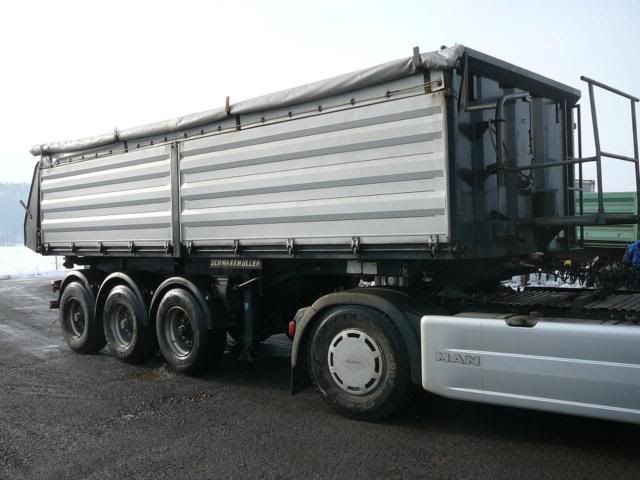

![[IMG]](proxy.php?image=http%3A%2F%2Fi166.photobucket.com%2Falbums%2Fu87%2Fbarun98989%2FtCY3Bm0KGrHqVjcE0DWlPYooBNE1UbZ45Q_27.jpg&hash=6687f40ee60b1925acbcf70dae08351c)
this is 2side tipper( left and rear) trailer by Schwarzmueller it is about 6500-7000kg heavy about 45-50m3 of load they are really flexible vehicles

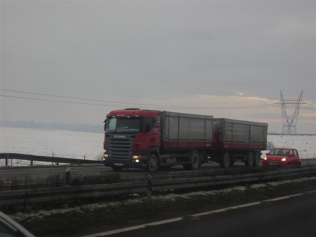

persoanlly i am fan of those vehicles as truck +drawbar trailer they are lighter and stronger than long tipper semitrailer as three above and better for ride
![[IMG]](proxy.php?image=http%3A%2F%2Fi166.photobucket.com%2Falbums%2Fu87%2Fbarun98989%2FDSC01151Large.jpg&hash=83e6cc5aa03a438820e031cd101a7e48)

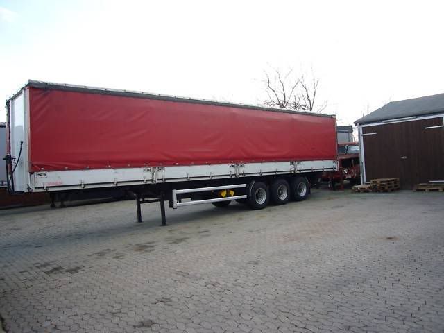

older schmitz semitrailer(with tarpaulinnon not tippers) had many problems with cracking frames above axles mostly on right side above middle axle...)
