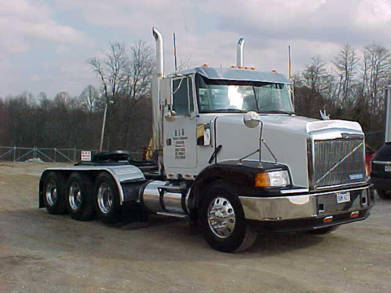

  4. Tug Toy
    Tug Toy Road Train Member
    7,130
    74,671
    Jul 4, 2015
    Corn field
    prostartom, W923 and farmerjohn64 Thank this.
  5. farmerjohn64
    6,383
    38,746
    Jun 25, 2019
    Oi that truck can’t be post 2000 lol I’m assuming that’s what op meant, but let’s be honest here, I don’t know sheet about trucks in terms of what engine is good and what manufacturer
